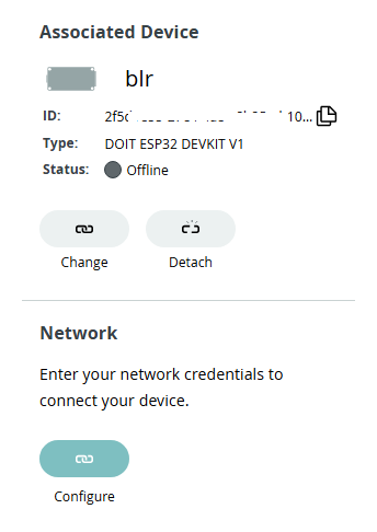

I am new to arduino IOT cloud.
my device is ESP32 Devkit v1
I associated the device, by selecting "DOIT ESP32 DEVKIT V1" and downloaded the device id and secret key.
But when trying to configure network, its greyed out
I already have Arduino agent running on my windows 10 computer.
Any thoughts on, how to get that table enabled and make device online?
Thanks.
Hi @sim_tcr. For some reason the network credentials configuration button is only enabled after you add at least one Arduino Cloud IoT Variable to the Thing.
Please give that a try. If you still have problems after adding Variables to the Thing, just let us know and we'll investigate further.

Select the "Setup" tab at the top of the page and verify that the "blr" Device is still shown under the "Associated Device" section of the "Setup" page, as it was at the time you took the screenshot you shared:
If the Device is no longer associated with the Thing, associate it once again.
If it is still associated, try the following procedure:
  1. Click the "Detach" button under the "Associated Device" section of the "Setup" page.
    The association between the "blr" Device and the Thing will be removed.
  2. Click the "Select Device" button under the "Associated Device" section of the "Setup" page.
    The "Associate device" dialog will open.
  3. Select the "blr" Device from the list of Devices in the dialog.
    The dialog will close and the "blr" Device will be associated with the Thing once again.
  4. Click the "Configure" button under the "Network" section of the "Setup" page.
    The "Configure network" dialog will open.
  5. Enter the credentials of your Wi-Fi access point in the dialog.
  6. Click the "SAVE" button in the dialog.
    The dialog will close.
  7. Select the "Sketch" tab at the top of the Thing page.
Now try compiling or uploading the Thing sketch once again. Hopefully it will be successful this time.
