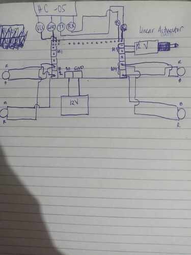

good day to all! i need help on how to properly code my project.
schematic diagram:
- i just finished working on how to control the movement of my car using a mobile app from play store, and it works perfectly fine. i used two 3.7v li-ion battery via arduino jack(linear actuator not included yet), but it is kind of slow when it comes to a not flat terrain. so i decided to upgrade my power supply to 12 volts via L293D motor shield ext power (still actuator not included yet), as expected the speed improved but the bluetooth module(hc-05) automatically disconnects after 5 secs controlling the car. can anyone help me in fixing this?
- i plan to connect a linear actuator (with a 12v power supply) if the above problem is fixed, the linear actuator alone functions really well with a 12v supply. i struggle on how to combine the code of the linear actuator along with the four TT motors. can you help me with this? i want my car to function as forward, reverse, left, and right. then when the car stop for 5 secs the actuator will extend for 10 secs and retract after 10 secs. as it retracts that iss the time i can control its movement again.
NOTE: the 2 items was tested separately

(BTW M1 on the motor shield is not functioning properly when i connect a motor)
