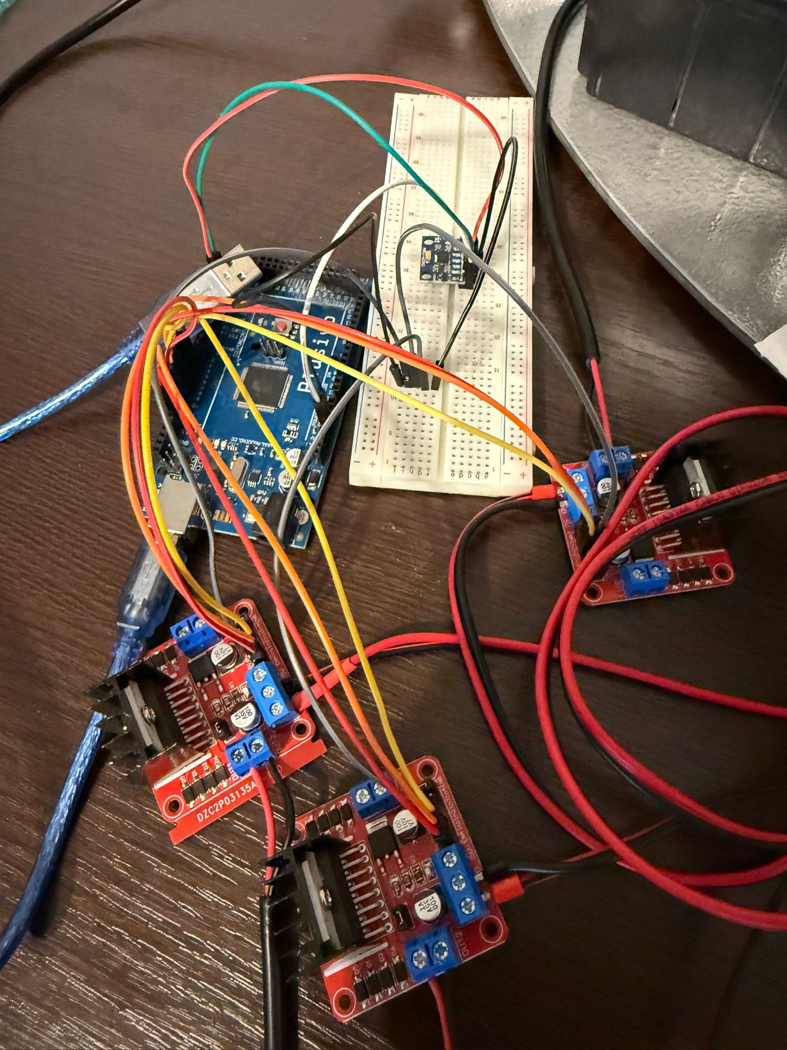

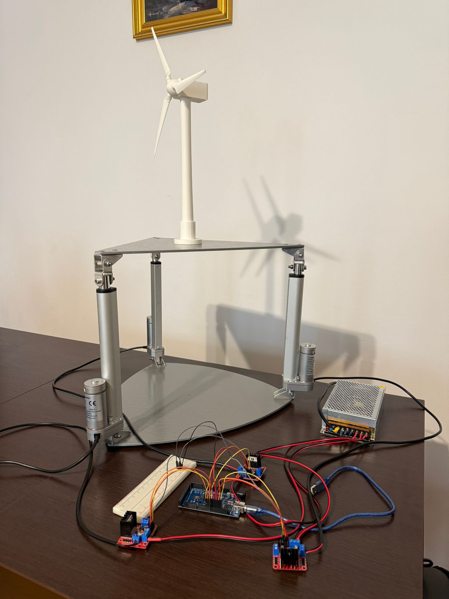

Hey! I’m working on a project where I need to control the tilt of a platform using a gyroscope (MPU6050) and three 12V linear actuators. The setup is controlled by an Arduino Mega, and each actuator is connected through its own L298N motor driver.
The actuators are powered by an external 12V supply, and I’m using IN1/IN2 + ENA (PWM) to control them from the Arduino.

For context:
- The actuators have encoders, and I plan to implement a control algorithm (probably PID) later, so I need precise movement and real-time stopping — no blocking delays.

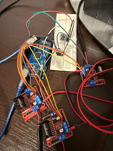

Sure, here’s my current setup (using 3 linear actuators with 3x L298N modules):
- Each actuator is powered from a 12V/14Ah lead-acid battery.
- For each actuator:
OUT1 and OUT2 of L298N go to the actuator motor wires.
VCC of L298N = 12V from the battery.
GND of L298N = GND of battery.
GND of L298N is also connected to Arduino GND (common ground).
- Control pins from Arduino:
- Actuator 1:
ENA = 9, IN1 = 6, IN2 = 5
- Actuator 2:
ENA = 10, IN3 = 7, IN4 = 8
- Actuator 3:
ENA = 11, IN5 = 12, IN6 = 4
- I use
analogWrite(ENA, HIGH) for full speed.
- Then I control direction with
digitalWrite(INx, HIGH/LOW).
The issue is:
If I do something like this:
digitalWrite(IN1, HIGH);
digitalWrite(IN2, LOW);
// then immediately
digitalWrite(IN1, LOW);
…then the actuator doesn’t move at all.
It only works if I insert a delay (e.g., delay(500)) between those commands.
But I don’t want to use delay() — I need to stop the actuator at a specific position later using feedback (encoders), so delay() just blocks everything and messes up the timing.
This is essential for the control algorithm I want to implement (probably PID), so I’m trying to figure out how to make it work without relying on fixed delays.
Let me know if this wiring and approach looks fine, or if I should change something. I’ll also upload a schematic and photos shortly.

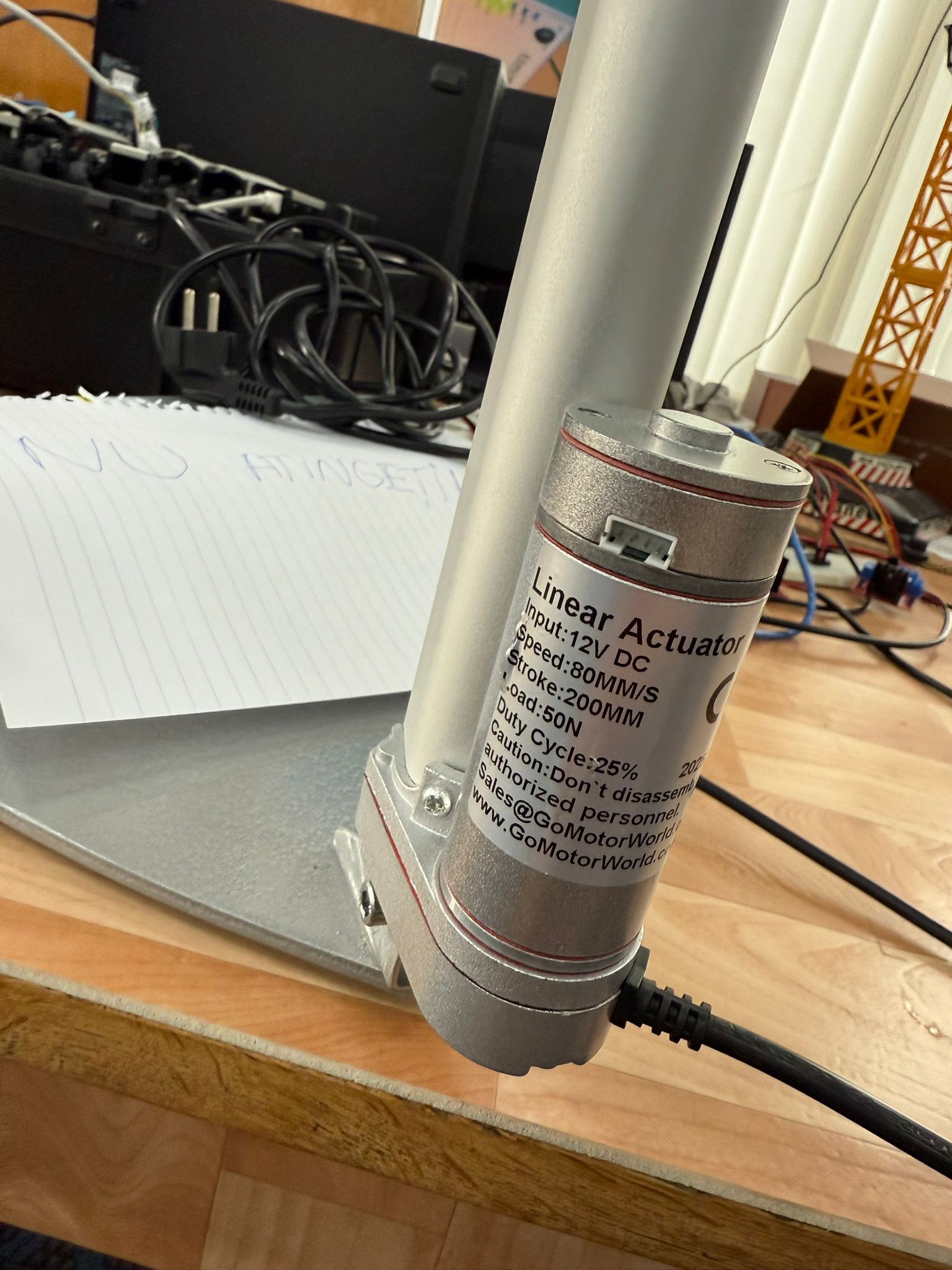

Post a link to the linear actuators. Many 12V ones draw over 5 Amperes every time they start moving, which is far above the maximum current that the L298 can handle.
I bought them from Ali Express

The product page is not entirely clear, but it appears that the rated maximum steady state current is 3A, so the start/stall current could be as high as 10A.
The L298 can handle only 1 Ampere steady state, so it is totally inadequate. Pololu has the best selection of motor drivers, and I recommend this one.
