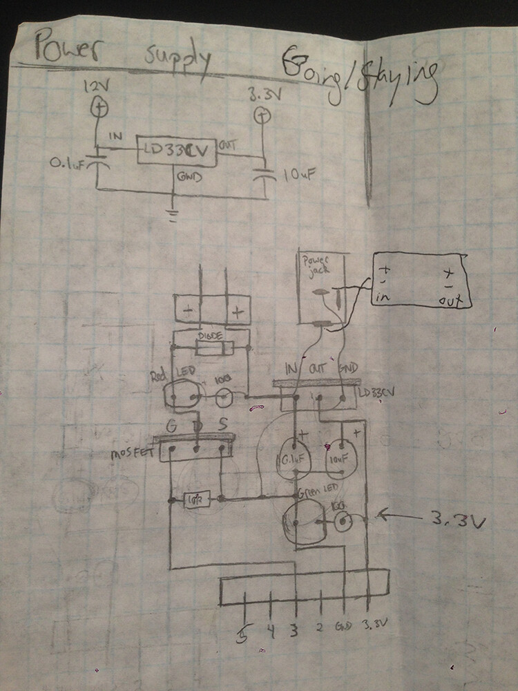

Hello! I have a project that will be part of a 2 month long exhibition. This means the project will be active 5 days a week, 7 hours a day for 2 months. I am concerned with how long the arduino fio (and the other components) that run the piece will last. The piece uses a 12v 5amp power supply that connects to a circuit that powers an actuator and arduino fio. The actuator is triggered frequently. The full duration of the piece is 5 minutes long.
I was wondering if using a Short Period Repeat Cycle Outlet Timer would help sustain the life of the piece. I could set it to be powered on for 5 minutes, then off for 3 minutes. I was curious if powering the arduino off/on like that is actually good or bad? Is it better to have the piece on for 30 straight minutes and then off for 10 minutes? What are the best intervals, or do you have other solutions to prevent burn out?
I'm attaching a schematic of the circuit. Sorry it's a little rough, and someone helped me build it, I'm kinda a newbie.
I guess aside from the arduino, I'm also worried about the regulator (Mosfet LD33CV) and the Converter 12V Step Down to 3.3V 3A. The circuit also uses some diodes, resistors, LEDs.

Basically the piece uses an arduino fio with a blink sketch to trigger the actuator to make a kick drum pedal beat on a kick drum. It's powered from a wall outlet.
Great! I do already have a heat sink on the regulator. So I guess it doesn't matter either way if I turn it on/off vs. just leave it running? If I want a delay between when the sketch loops should I just factor in a delay at the end of the code, or turn the piece off?

Those are made to be used intermittently. How much time is used to actuate the lock and how much time is power removed. Most electronics is ok if you can keep you hand on it.
Paul
Can you please post a complete copy of your circuit, in CAD or a picture of a hand drawn circuit in jpg, png?
Using component symbols and labelling pins etc.
You diag does not tell us where the actuator is connected, where your Arduino is connected, what model Arduino are you using.

Update: Everything lasted the whole exhibition no problem except my door lock actuators (they lasted between 5-8 days). The piece did run in 30 minute intervals, with a 5 minute break. I'm on the hunt for a better motor solution, but haven't found anything yet :confused: Some rack and pinion type have been recommended to me, but I haven't been able to find a viable one that will work with my project yet. Need something that will pull 1" multiple times a second for extended durations.
isaralynn:
Sounds like a job for a solenoid. Door openers are built around solenoids usually. Very likely those door openers are made with a somewhat underpowered solenoid, as they're designed to be on for a few seconds at a time, then off for long time. So a smaller solenoid makes them cheaper, but won't last when pushed like you do.
Update #2: I've updated my motors to these solenoids: McMaster-Carr
I haven't used them in an exhibition yet, but they are much quieter and seem a lot more reliable than the previous motors I was using since these don't use any plastic gears that can go bad.
Might want to look into dual-circuit solenoids.. They have a high power "pull-in" coil and a low power "hold" coil, this gives them both the strength to pull with significant force, as well as a low power draw so they can stay on for extended periods of time without overheating.. There are also microchips (LM1947) designed for fuel injectors that can be repurposed for this, the drop the amperage by a factor of 4 after a set time which drastically reduces heat buildup in the coil.
