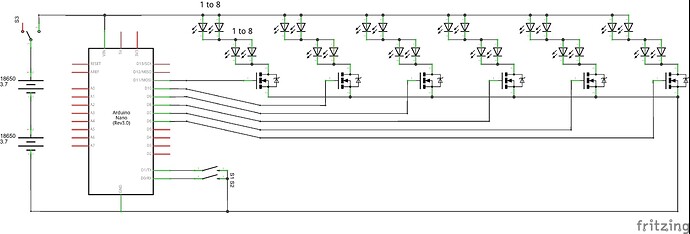

Hello everyone .... first of all congratulations for your projects.
Even I'm starting to build a lightsaber following your instructions ... but I have a little doubt.
Having never run so many LEDs together ... I would understand if it is better to place the load resistors for LEDs, or not.

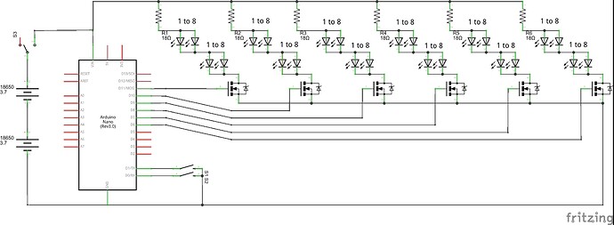

The leds I bought, are the Straw Hat 5mm red (1,8-2,2v and about 30ma ... STRAWHAT STRAW HAT 180gradi 100 LED ROSSI 5000mcd 5mm + RESISTENZE A2C25.A2C48 | eBay).
Wanting to create a series-parallel LED string consists of 6 groups of 8+8 leds ... My calculations say that I need 6 resistors 18R 1w.
They are so necessary, given the low value ???
I have seen some schemes around, and often these resistors are not mentioned.
Attaching any two schemes ... do you think is correct?
Thanks so much
integra386.. i dont know but... you are making a blade with 96 leds?

Chivontekai ... Yes ... 96 leds

As to the resistors or not: for a red blade with serial II. technic (2 LEDs in series), you need the resistors, otherwise you will have a very narrow band to control your transistors -> effects will be less spectacular. Not to mention that not all small transistors can tolerate the power dissipated over them.
Better is to use a serial III. setup, then you do not need the resistors. 2.2V*3=6.6V, you only need to dissipate max. 8.2V-6.6V=1.6V over the MOSFET. If you insist on the serial II., then you need the resistors.
BTW, looking at your schematics, please do not forget the pull-down resistors from transistor gate to GND, otherwise you will have floating gate and you cannot control switch on/off (all LEDs will always be somehow in a random on state).
Protonerd thanks for the reply .... then I will make from 96 to 90 LED ... 6 x ( 3 x 5 ) .
I updated again the scheme ... now should be correct .

I tested the scheme led to 6 x (3 x 5) ... however, I need resistors (about 10 ohm) ... the light is inconsistent and leds become very hot.
I tried it with a resistance test and it's all ok.
Only real problem ... I miscalculated ... for a sword of about 90cm ... I'll need more LEDs ... 126 in all!
6 x (3 x 7) ... may the force be with me ... but above all ... the patience!
To not have as many cables inside the blade, I ordered from SMD resistors 2w (same size as 1w ... but more is better) that i'ss weld directly on the LED, so I'll keep only one positive cable.
