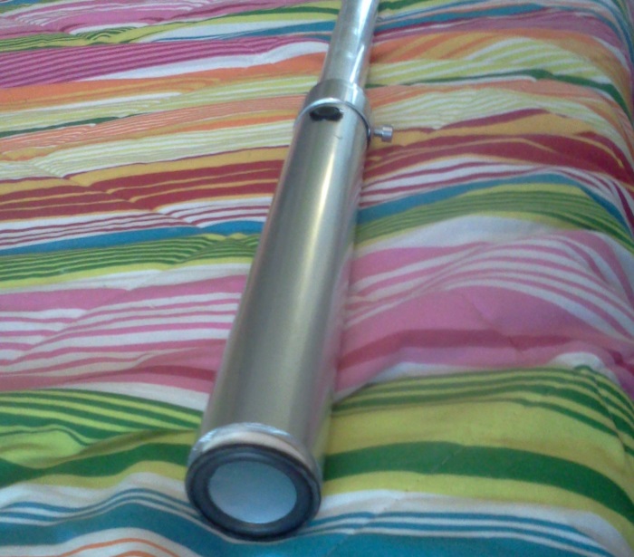

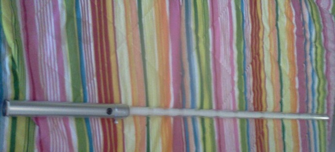

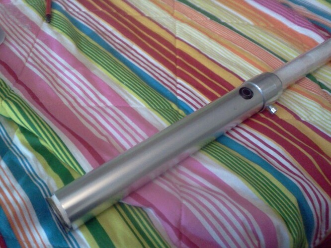

I see there's already someone else with an arduino based lightsaber, but here's mine:
I did cheat a bit, instead of a regular arduino, it uses a maple mini (72Mhz, 128kb flash, 20kb ram), but the arduino environment was ported to it, so it's programmed using the arduino toolchain. The extra speed made it easier to control the ledstrips, and the extra memory means i could easily store the sounds it currently has in the flash memory :).
it uses ws2812b ledstrips for the lights (and i diffused them with some white foil, so irl you see the leds a bit, but it still looks very well)
and put a tda2003 amp and an 8bit dac and a speaker in the bottom to get some sound :).
Glad i got it working well enough as the 7th movie is released :).
And some pictures of it:
I can't see leds when it's lightening, pretty sweet :slight_smile:

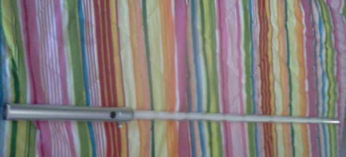

i went with 2 strips back to back, and diffused them with milk white foil for windows taped directly to them, then a layer of bubblewrap (mostly transparent, and very soft :slight_smile: ),and then wrapped them in very thin white cloth (i cut up an overall to protect your clothes while painting) to do some more diffusing. Here are some pictures of the result:
wrapped ledstring
Top of the ledstring, with a bit of just the ledstrings with the white foil around them sticking out
For me the biggest challenge was diffusing it properly without loosing too much brightness, and without it being ugly. I started out with just the white foil, but 2 layers of it already starts dimming it a lot, and no matter what you do, you'll see the seams of where the foil starts/stops. So then i noticed this painters overall i had with very thin cloth, which i could easily do 3-4 layers of, without dimming too much, diffusing pretty wel, and the seams are barely noticable :).
And the strips themselves are ws2812b strips with 60 leds per meter. The 144 leds per would probably be even more awesome (but are relatively expensive).
I was also worried about thermal issues, but i tested this setup on full white (and a 4.2v power supply, the highest voltage my 18650 battery can have) for 15 minutes, and it started to get hot, but held up very well :slight_smile: (if i had 144leds per meter strips, i would expect getting issues using them at full power).
Ow, and another "pro tip" XD. When i did the weekend of experimenting on diffusing them, i ended up making sure every layer is properly connected to every other layer :p. Nothing more annoying that trying to pull out your ledstring from the tube, the layers not coming out perfectly together, meaning you can start over making the entire diffusing assembly XD
To save on needed components, i'm driving everything directly from the battery. Tested the ws2812 strips on various voltages, and below 3.4 volt, you see them really degrading, white not being that white anymore etc.. and ofcourse as the voltage lowers, they get a bit dimmer, but just hooking them directly to my lithium ion battery really worked surprisingly well :).
After some more googling today, i discovered there exists spray paint for frosting glass, i'm going to see if i can find any, and frost the polycarbonate tube i have, and that should make it even better :).
*edited, i forgot that there also was a layer of bubblewrap around the leds :slight_smile:

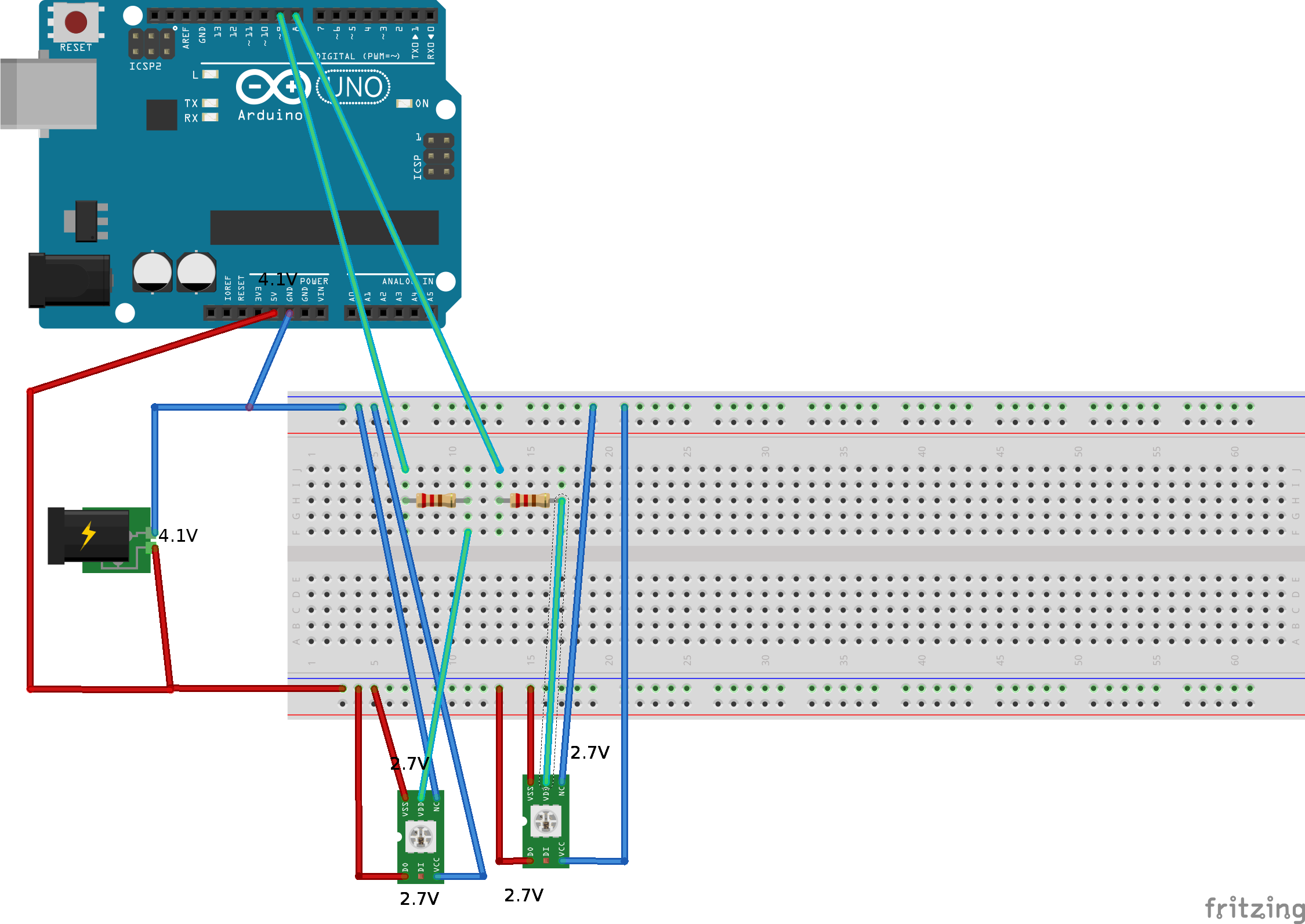

Hi di you have a problem with the voltage drop in the led strip?
I'm doing the same thing with 144led/M strip and with powering only one side it drops at least 2V, I'll test powering both sides
bodtx:
What is your power supply voltage? If you really use 5V supply, the high current draw will bring the supply to its knees. Actually something about 3.2V supply would be enough. Thing is - and this is not mentioned in the data sheet - voltage above the Vth of the LEDs will be dissipated passively over whatever protection circuit they have - with other worlds this energy is wasted.
My power supply is 4 nimh batteries cells (4000 mA each). Theese are special Radio Ccontroled car batteries (should deliver up to 20A)
At the begining I'm at 4.9V and at the end I was at 2.8V

Ok so back with a new test, I've powered up both line, so I run a test for 8 minutes, no batteries problem, I run two 144 led with no voltage drop problem
so I run 288 led at full green end full blue.
it draws 4A
I've checked the voltage and I have a strange voltage drop that I don't understand, why near my batteriy I have 4.1V and why on the strip both end I have 2.7?
If I plug the arduino power on the breadboard near the strip it reset when voltage on strip is nears 3.3 (wich is the minimum for a Atmega328P@20Mhz
I thought connection in // does not suffer from voltage problem?
But that said it works correctly, but with a good voltage my strip would be even lighter
see the schema (it is one led in it, but it is to compact the view, the 2 strips are with 144 led)
thx

Could it be that your voltmeter is confused by all the noise these strips generate?
When building my saber i put several capacitors in between them and the rest of my project since i was getting a lot of noise on the powerline.
