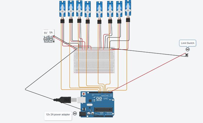

I have an arduino project controling 8 servo motor it functions as follows : i press the button each servo rotates to 90 degree and when all servos are at 10 degrees the all turn back to 0 , i have external 5v 5A power supply for the motors ans external power abapter to arduino i connected 2 220v cooling fans to cool down my components while the fans are connected the sequence starts on its own i disconnect the fans from power the whole thing becomes stable again and only starts when i press the button, what could be the issue here ?
here is my diagram and code:

Is there anything in your project, either hardware of software that is keeping the input pin LOW when the switch is not closed ?
If not then it is floating at an unknown voltage, maybe HIGH. maybe LOW. maybe changing because it is picking up electrical noise from the environment
no nothing in my hardware is keeping it low when not pressed, i think you're correct but how can i solve this issue ?
You need a pull-down resistor to keep the input from floating to an unknown state.
Or, you can wire the switch to ground, enable the built-in pull-up resistor and reverse the logic in your code.
You could add a 10K resistor between the input pin and GND to hold the pin normally LOW
Personally I would use INPUT_PULLUP in the pinMode() for the input pin to turn on the built in pullup resistor so no extra hardware is required. If you do this, change the circuit so that pin is taken LOW when the switch is closed and detect LOW in the sketch to indicate that the switch is closed

the switch is wired to ground and pin D2, i'm using pinMode(SWITCH_PIN, INPUT_PULLUP) , i think this enables the built in pull up resistor ?
i'm actually using INPUT_PULLUP in the pinMode() , i uploaded the sketch.
If you are already using INPUT_PULLUP then that explains what you say in your topic title
Arduino limit switch reading as high without pressing it
you mean i should reverse the code and read the button when LOW ?
Yes, if the circuit is wired to take the input LOW when the switch is closed which it seems to be. Unless, of course, the switch is normally closed which cannot be determined from your diagram. This one reason why users are asked to post a schematic rather than a graphical representation of the circuit
the switch is wired normaly closed yes , but if i reverse it and there is an electrical noise wouldn't that create same problem , i mean the switch won't be able to go low when there is noise around it?
You are making things sound complicated when they are not
The input pin needs to always be in a fixed state whether it is open or closed
Your Normally Closed switch connects the pin to GND when closed so it is normally in a fixed LOW state
You have used INPUT_PULLUP so that when the switch is opened the pin will go HIGH so will be in a fixed HIGH state
In neither case will it be floating
To detect that the switch has been operated (ie opened) you should test for a HIGH state
do you think adding 100 µF capacitor to the limit switch can fix the issue ?
i don't see a ground connection between the arduino and breadboard
NO
You do not need a capacitor connected to the switch. When the switch is wired correctly and INPUT_PULLUP is used in the pinMode() for the input pin the pin will be in a fixed state whether it is open or closed
In your sketch you have the following
if (digitalRead(SWITCH_PIN) == LOW && !sequenceRunning)
        Serial.println("Button pressed");
The state of the switch pin will only be LOW when the switch is closed, but that is its normal state. If you want to detect when the switch is operated, ie opened, then you need to test for HIGH
Have you tried measuring the state of the input pin with a DMM to ensure that it is behaving as expected ?
there is a black line from arduino's ground to the breadboard's ground , bit on the left on the photo
i haven't yet, but i will test for that.
You don not appear to have a GND connection between the Arduino and the breadboard or power supply. If that is the case then the Arduino is trying to compare the voltage between 2 different systems with no common point of reference
