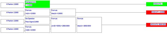

I've been working on a small project, To make a remote DRO for MAch3 using Modbus.
I've got it working (just on the X Axis at the moment) but I'm either not creating the brain correctly or the conversion is not right and hopefully some one on here may a bit more of a clue than me.
What's happening when I view the brain I can see that the reading is 2.2650 and Int(A) =2.0000 and then this formula (A-B)*10000) = 2650.0000 that is been sent looking at the picture below but when I print this on my LCD the value is showing 2.2649 ?
Even if I print the xc & xc1 value still showing on the LCD is xc=2(correct) and xc1=2649 and not 2650 like it is in the brain
This is the code I'm using not sure what's or where I'm going wrong

And this is a picture of the brain set up
Are you sure your 'brain' rounds to the nearest thousandths? x.xxx0
not sure the DRO in mach3 reads exactly the same as the brains every time I move it it it's the same if the MAch3 DRO reasds 12.0200 same as the brains but my LCD display read 12.0199.
Still can't quite get to the bottom of it
