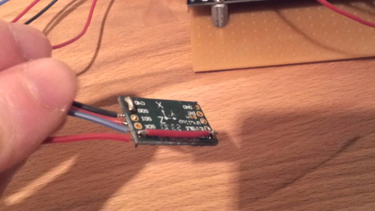

But SCL is 21 and SDA is 20 on the MEGA and I connected not to D12, I connected to 5V.
What does this mean? Show how you have actually connected the thing to the Arduino - a decent photo would probably be best.

I have problems to add a picture here, so I try this:
This is how I connect the BMA020 to the Arduino MEAG 2560:
BMA020 PINs Arduino
UIN / Pullup / CSB to 5 Volt
ENABLE
INT
GND
SCK to SCL (21)
SDI to SDA (20)
SDO / GND to GND
My last tests today give me the opinion that I get values form the sensor and they change if I move it, but I think they are confuse.

@PaulS: Here a link to a video of my wiring:
http://youtu.be/vmuExqRfz6Q
