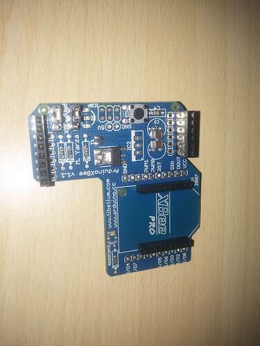

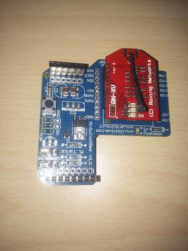

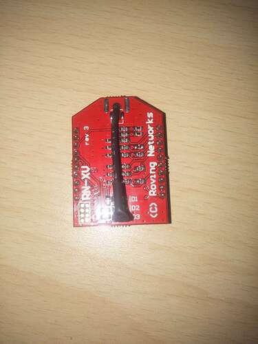

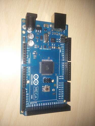

My configuration is:
  • Arduino Mega 2560 rev. 3
  • Arduino XBee v1.1
  • Module WiFi Roving Networks WiFly RN-171B
So, you don't have an XBee shield? Are you duct taping the XBee onto the Arduino? What is the WiFi device for? Is it duct-taped on, too?
Yes, i've Arduino Xbee v1.1 as Xbee Shield.
I plug WiFly RN-XV171 on Arduino Xbee and all (ARduino Xbee + WiFly Module) after on Arduino Mega 2560.
