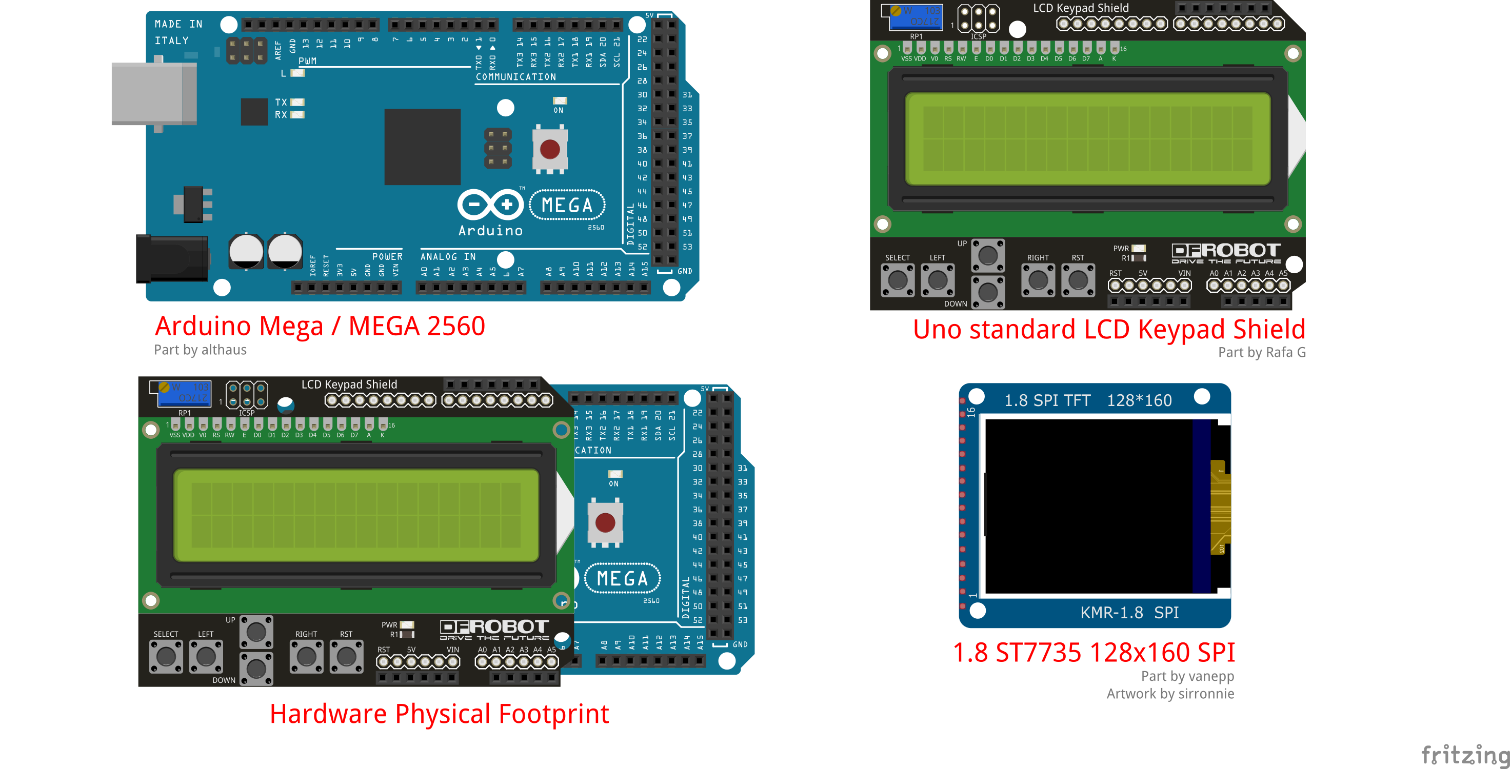

A firmware to expand your hardware from the setup of Arduino MEGA or MEGA 2560 clone boards with Arduino standard LCD Keypad Shield and 1.8 128x160 SPI TFT ST77xx Display with hard SPI. (TFT Default Orientation: Portrait).
What you need other than basic components like wires, caps, resistors or breadboards.
Circuit Decoupling Capacitor Recommended Value: 10ΞΌF. Use electrolytic only if ceramic caps are unavailable.
Limiting resistor for the LED+ Backlight input for the TFT Screen: 220Ξ©.

 * Target Hardware: Arduino MEGA 2560 + LCD Keypad Shield + 1.44" ST7735 TFT
 * β”Œβ”€β”€β”€β”€β”€β”€β”€β”€β”€β”€β”€β”€β”€β”€β”€β”€β”€β”€β”€β”€β”€β”€β”€β”€β”€β”€β”€β”€β”€β”€β”€β”€β”€β”€β”€β”€β”€β”€β”€β”€β”€β”€β”€β”€β”€β”€β”€β”€β”€β”€β”€β”€β”€β”€β”€β”€β”€β”€β”€β”€β”€β”€β”€β”€β”€β”€β”€β”€β”€β”€β”€β”€β”€β”€β”€β”€β”€β”€β”€β”€β”€β”€β”€β”€β”€β”€β”€β”€β”€β”€β”€β”€β”€β”
 * β”‚                                    HARDWARE LAYOUT                                          β”‚
 * β””β”€β”€β”€β”€β”€β”€β”€β”€β”€β”€β”€β”€β”€β”€β”€β”€β”€β”€β”€β”€β”€β”€β”€β”€β”€β”€β”€β”€β”€β”€β”€β”€β”€β”€β”€β”€β”€β”€β”€β”€β”€β”€β”€β”€β”€β”€β”€β”€β”€β”€β”€β”€β”€β”€β”€β”€β”€β”€β”€β”€β”€β”€β”€β”€β”€β”€β”€β”€β”€β”€β”€β”€β”€β”€β”€β”€β”€β”€β”€β”€β”€β”€β”€β”€β”€β”€β”€β”€β”€β”€β”€β”€β”€β”˜
 * Hardware Components:
 * > Arduino MEGA 2560 (ATmega2560 MCU @ 16MHz)
 * > LCD Keypad Shield (Arduino standard, MEGA compatible pin layout)
 * > KMR 1.8" TFT 128x160 SPI ST7735 Display
 * Default Hardware Layout:
 * [D7]~[D6]~[D5]~[D4]~[D3]~[D2] [D1] [D0]  [D14 to D21 UART Communication]  O  [5V5] [5V5]──►● VCC───────TFT VCC
 *LCD Keypad Shieldβ–ˆβ–ˆβ–ˆβ–ˆβ–ˆβ–ˆβ–ˆβ–ˆβ–ˆβ–ˆβ–ˆβ–ˆβ–ˆβ–ˆβ–ˆβ–ˆβ–ˆβ–ˆβ–ˆβ–ˆβ–ˆ   β”‚                                   ~[D44]~[D45]
 *β–ˆβ–ˆβ–ˆβ–ˆβ–ˆβ–ˆβ–ˆβ–ˆβ–ˆβ–ˆβ–ˆβ–ˆβ–ˆβ–ˆβ–ˆβ–ˆβ–ˆβ–ˆβ–ˆβ–ˆβ–ˆβ–ˆβ–ˆβ–ˆβ–ˆβ–ˆβ–ˆβ–ˆβ–ˆβ–ˆβ–ˆβ–ˆβ–ˆβ–ˆβ–ˆβ–ˆβ–ˆβ–ˆ   β”‚                            LED ●◄─~[D46] [D47]                           [KMR 1.8 TFT LCD]
 *β–ˆβ–ˆβ–ˆβ–ˆβ–ˆβ–ˆβ–ˆβ–ˆβ–ˆβ–ˆβ–ˆβ–ˆβ–ˆβ–ˆβ–ˆβ–ˆβ–ˆβ–ˆβ–ˆβ–ˆβ–ˆβ–ˆβ–ˆβ–ˆβ–ˆβ–ˆβ–ˆβ–ˆβ–ˆβ–ˆβ–ˆβ–ˆβ–ˆβ–ˆβ–ˆβ–ˆβ–ˆβ–ˆ   |                            RST ●◄──[D48] [D49]──►● A0/DC
 *                                         |                                    [D50] [D51]──►● SDA/MOSI (Hard)
 *                                         |                  SCL/SCK(Hard) ●◄──[D52] [D53]──►● CS
 *                                        / M E G A   2 5 6 0                   [GND] [GND]──►● GND ──┬─── GND
 * _________[A0]_[A1]_[A2]_[A3]_[A4]_[A5]/[A6] [A7]    [A8 to A15  Analog  Pins]     O      β•‘        ___
 * ══════════│══════════════════════════════════════════════════════════════════════════════╝         _
 *           └─ Keypad ADC Input
 * KEY: "~" = PWM supported Pinouts.
 * β”‚                                   CONNECTION TABLE                                          β”‚
 * β”œβ”€β”€β”€β”€β”€β”€β”€β”€β”€β”€β”€β”€β”€β”€β”€β”€β”€β”€β”€β”€β”€β”€β”€β”€β”€β”€β”€β”€β”€β”€β”€β”€β”€β”€β”€β”€β”€β”€β”€β”€β”€β”€β”€β”€β”€β”€β”€β”€β”€β”€β”€β”€β”€β”€β”€β”€β”€β”€β”€β”€β”€β”€β”€β”€β”€β”€β”€β”€β”€β”€β”€β”€β”€β”€β”€β”€β”€β”€β”€β”€β”€β”€β”€β”€β”€β”€β”€β”€β”€β”€β”€β”€β”€β”€
 * β”‚  COMPONENT           β”‚  ARDUINO PIN    β”‚  DESCRIPTION                                       β”‚
 * β”‚  LCD KEYPAD SHIELD   β”‚                 β”‚                                                    β”‚
 * β”‚  β”œβ”€ LCD_RS           β”‚  D8             β”‚  LCD Register Select                               β”‚
 * β”‚  β”œβ”€ LCD_EN           β”‚  D9             β”‚  LCD Enable                                        β”‚
 * β”‚  β”œβ”€ LCD_D4           β”‚  D4             β”‚  LCD Data Bit 4                                    β”‚
 * β”‚  β”œβ”€ LCD_D5           β”‚  D5             β”‚  LCD Data Bit 5                                    β”‚
 * β”‚  β”œβ”€ LCD_D6           β”‚  D6             β”‚  LCD Data Bit 6                                    β”‚
 * β”‚  β”œβ”€ LCD_D7           β”‚  D7             β”‚  LCD Data Bit 7                                    β”‚
 * β”‚  β”œβ”€ LCD_BL           β”‚  D10 (PWM)      β”‚  LCD Backlight Control                             β”‚
 * β”‚  └─ KEYPAD_PIN       β”‚  A0 (ADC)       β”‚                                                    β”‚
 * β”‚  ST7735 TFT DISPLAY  β”‚                 β”‚                                                    β”‚
 * β”‚  β”œβ”€ TFT_CS           β”‚  D53            β”‚  SPI Chip Select                                   β”‚
 * β”‚  β”œβ”€ TFT_RST          β”‚  D48            β”‚  Reset Pin                                         β”‚
 * β”‚  β”œβ”€ TFT_DC           β”‚  D49            β”‚  Data/Command Pin (A0)                             β”‚
 * β”‚  β”œβ”€ TFT_MOSI         β”‚  D51 (HW SPI)   β”‚  SPI Data Out (Hardware SPI)                       β”‚
 * β”‚  β”œβ”€ TFT_SCLK         β”‚  D52 (HW SPI)   β”‚  SPI Clock (Hardware SPI)                          β”‚
 * β”‚  β”œβ”€ TFT_LED          β”‚  D46 (PWM)      β”‚  Backlight Control                                 β”‚
 * β”‚  β”œβ”€ VCC              β”‚  5V             β”‚  Power Supply                                      β”‚
 * β”‚  └─ GND              β”‚  GND            β”‚  Ground                                            β”‚

TFT LED Backlight control Pin Notes:
Arduino MEGA (or clones) has the following pins exposed for PWM capability: D44, D45 and D46.
Most Arduino standard LCD keypad shield will have soldering breakouts for pins D1 to D7 (as the rest of the pins are used by the TFT Shield.)
So the candidates for the backlight control pin for Digital PWM control are the D pins mentioned (The Analog A Pins are mentioned for positional reference):
[D7] [D6] [D5] [D4] [D3] [D2] [D1] [XX]   [D14 to D21 UART Communication]  O  [5V5] [5V5]β•‘
                                     └─►<D0 N/A>                                 .....
  LCD Keypad Shield                     ....                                  [D44] [D45]
                                         β”‚                                    [D46] [XXX]──►<D47 and onwards or before D44, no PWM capability>
                                         β”‚                                       .....
                                        / M E G A   2 5 6 0                   [GND] [GND]β•‘
_______________[A1]_[A2]_[A3]_[A4]_[A5]/[A6] [A7]    [A8 to A15  Analog  Pins]     O     β•‘
Use it as per your hardware requirement.
           β”‚
           β–Ό
#define TFT_LED  46    // LED control pin || -1 for no pin hard control)
