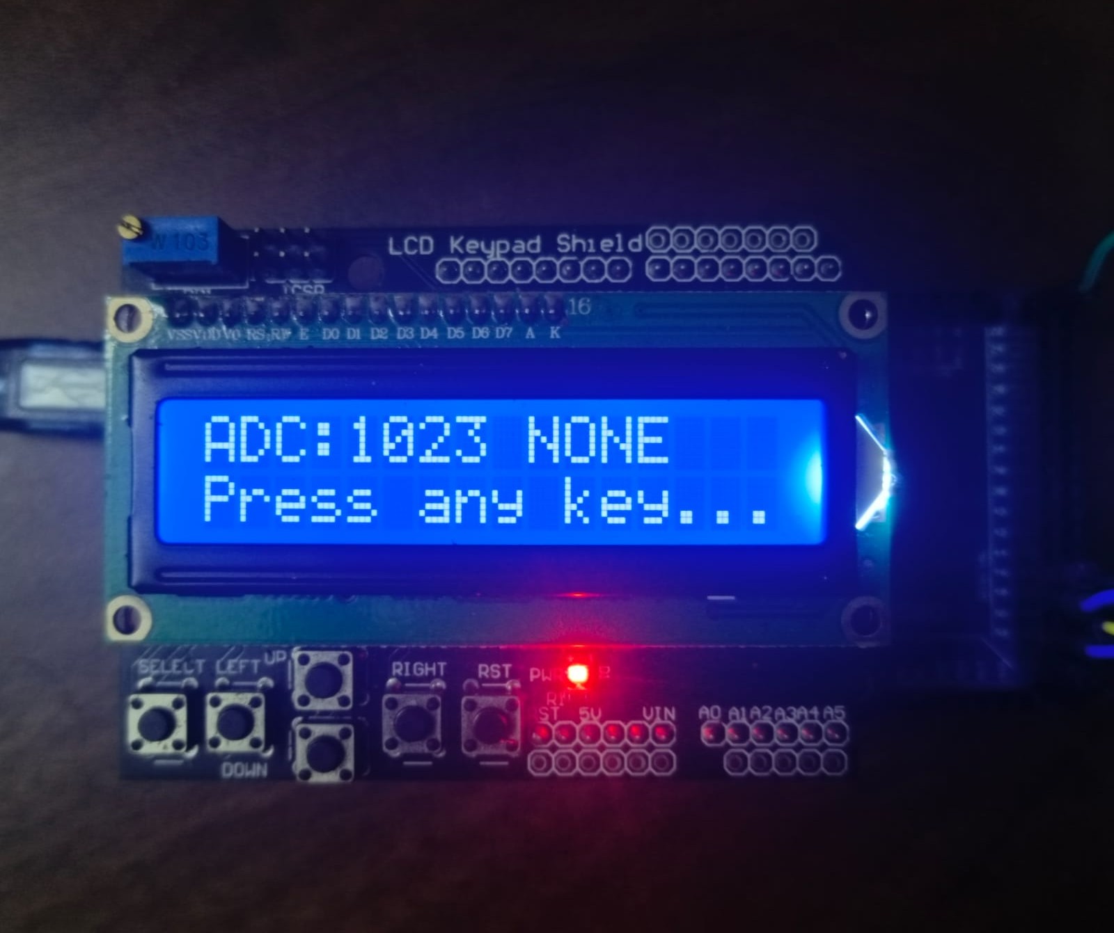

Arduino compatible LCD Keypad Shield ADC Reader
An example sketch for lcd keypad shield which acts as a ADC value tester for the buttons and the hardware Voltage Divider implemented with the A0 pin for any Arduino standard LCD Keypad Shield. Wet tested with Arduino UNO and MEGA.

 *  ║                    LCD KEYPAD SHIELD PIN LAYOUT                       ║
 *  ║   │ ┌─────────────────────────────────────────────────┐ │ LCD DISPLAY ║
 *  ║   │ │  (5x8)x16x2 dots LCD Display | Hitachi HD44780  │ │   MODULE    ║
 *  ║   │  [RIGHT] [UP] [DOWN] [LEFT] [SELECT]                │             ║
 *  ║   ┌────────────────────────┼─ SHIELD CONNECTION ────────────────────┐ ║
 *  ║   │    ARDUINO MEGA 2560 / UNO DIGITAL PINS                         │ ║
 *  ║   │    Pin  4  ────────── LCD Data 4 (D4)                           │ ║
 *  ║   │    Pin  5  ────────── LCD Data 5 (D5)                           │ ║
 *  ║   │    Pin  6  ────────── LCD Data 6 (D6)                           │ ║
 *  ║   │    Pin  7  ────────── LCD Data 7 (D7)                           │ ║
 *  ║   │    Pin  8  ────────── LCD Register Select (RS)                  │ ║
 *  ║   │    Pin  9  ────────── LCD Enable (EN)                           │ ║
 *  ║   │    Pin 10  ────────── LCD Backlight Control (Optional)          │ ║
 *  ║   │    ANALOG PINS                                                  │ ║
 *  ║   │    Pin A0  ────────── Keypad Voltage Divider                    │ ║
 *  ║   │    POWER CONNECTIONS                                            │ ║
 *  ║   │    5V      ────────── LCD VCC & Keypad VCC                      │ ║
 *  ║   │    GND     ────────── LCD GND & Keypad GND                      │ ║
 *  ║   KEYPAD RESISTOR LADDER (Estimated ADC Values):                      ║
 *  ║   │  BUTTON │ ADC RANGE   │              NOTES                      │ ║
 *  ║   │  RIGHT  │   0 -  80   │ Direct connection to GND                │ ║
 *  ║   │  UP     │  81 - 150   │ 330Ω resistor to GND                    │ ║
 *  ║   │  DOWN   │ 151 - 270   │ 620Ω resistor to GND                    │ ║
 *  ║   │  LEFT   │ 271 - 620   │ 1kΩ resistor to GND                     │ ║
 *  ║   │  SELECT │ 621 - 880   │ 3.3kΩ resistor to GND                   │ ║
 *  ║   │  NONE   │ 881 - 1023  │ 10kΩ pull-up to 5V (no button)          │ ║

#include <LiquidCrystal.h>
// Initialize the library with the interface pins
// Standard LCD Keypad Shield connections for Arduino MEGA 2560
LiquidCrystal lcd(8, 9, 4, 5, 6, 7);
// Analog pin for keypad reading
#define KEYPAD_PIN A0

// Key detection thresholds - made more robust with hysteresis
struct KeyThreshold {
  int lower;
  int upper;
  const char* name;
const KeyThreshold KEY_THRESHOLDS[] = {                 // Set as per the callibration of Hardware 0.
  {0, 80, "RIGHT"},      // ~0-50 typical, with margin
  {81, 150, "UP"},       // ~130-160 typical, with margin
  {151, 270, "DOWN"},    // ~300-330 typical, with margin
  {271, 620, "LEFT"},    // ~480-510 typical, with margin
  {621, 880, "SELECT"},  // ~720-750 typical, with margin
  {881, 1023, "NONE"}    // No key pressed
const int NUM_KEYS = sizeof(KEY_THRESHOLDS) / sizeof(KeyThreshold);

    updateBottomLine(lastAverage, lastStdDev);
  } else if (keyPressed_bool && keyCurrentlyPressed) {
    // Key still pressed - update running statistics with overflow protection
    if (adcCount < MAX_SAMPLES && adcSum < MAX_ADC_SUM) {
      adcSum += (unsigned long)adcValue;
      adcSumSquares += (unsigned long)adcValue * (unsigned long)adcValue;
      adcCount++;
      // Track min/max safely
      unsigned int currentAdc = (unsigned int)adcValue;
      if (currentAdc < minAdc) minAdc = currentAdc;
      if (currentAdc > maxAdc) maxAdc = currentAdc;
      // Calculate new statistics only if we have enough data
      if (adcCount > 1) {
        int newAverage = (int)(adcSum / adcCount);
        // Calculate standard deviation with overflow protection
        unsigned long meanSquares = adcSumSquares / adcCount;  // E[X²]
        unsigned long avgSquared = (unsigned long)newAverage * (unsigned long)newAverage;  // (E[X])²
        int newStdDev = 0;
        if (meanSquares >= avgSquared) {  // Prevent negative variance
          unsigned long variance = meanSquares - avgSquared;
          newStdDev = (int)sqrt(variance);
        // Only update display if values actually changed
        if (newAverage != lastAverage || newStdDev != lastStdDev) {
          lastAverage = newAverage;
          lastStdDev = newStdDev;
          updateBottomLine(newAverage, newStdDev);
      // Overflow protection - stop accumulating but continue tracking min/max
  } else if (!keyPressed_bool && keyCurrentlyPressed) {
    // Key just released
    keyCurrentlyPressed = false;
    // Reset tracking variables safely
    adcSum = 0;
    adcSumSquares = 0;
    adcCount = 0;
    lastAverage = -1;
    lastStdDev = -1;
    minAdc = 1023;
    maxAdc = 0;
    updateBottomLine(-1, -1); // Clear average display
  // Only update top line if values changed (prevents flickering)
  if (adcValue != lastAdcValue || keyIndex != lastKeyIndex) {
    updateTopLine(adcValue, keyName);
    lastAdcValue = adcValue;
    lastKeyIndex = keyIndex;
  // Small delay for ADC stability
  delay(20);

void updateTopLine(int adcValue, const char* keyName) {
  // Update ADC value (with fixed position)
  lcd.setCursor(4, 0);
  lcd.print(F("    ")); // Clear previous value
  lcd.print(adcValue);
  // Update key name - only clear what's needed
  lcd.setCursor(9, 0);
  lcd.print(F("       ")); // Clear previous key name
  lcd.print(keyName);
void updateBottomLine(int average, int stdDev) {
  lcd.setCursor(0, 1);
  lcd.print(F("                ")); // Clear entire line once
  if (average == -1) {
    // No key pressed - show ready message
    lcd.print(F("Press any key..."));
    // Key pressed - show running average ± standard deviation
    lcd.print(F("AVG:"));
    // Right-align numbers with proper formating
    if (average < 100) lcd.print(F(" "));
    if (average < 10) lcd.print(F(" "));
    lcd.print(average);
    lcd.print(F(" "));
    lcd.write((uint8_t)CHAR_PLUS_MINUS); // Use the custom plus-minus character
    if (stdDev < 100) lcd.print(F(" "));
    if (stdDev < 10) lcd.print(F(" "));
    lcd.print(stdDev);
