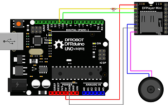

I am trying to connect my mega 2560 to a dfplayer mini. I have connected my dfplayer mini directly with only buttons and it worked. i currently have it wired like this.

is this some kind of error with the compatability of my code with my board or is it some kind of wiring issue. please help
D2, D3 in sketch vs D10,11 in hastily pasted diagram
heavy sigh
Irrelevant, this is a mega2560.
The player should be connected to TX1, RX1 pins.
Hmm. Text says Mega. Picture shows an Uno.
Let's assume Mega is correct.
Are you using an Uno or ESP8266?
No?
Then these lines will not apply:

Hmm again. So where does Serial1 come out on a Mega?
Looks like 18 and 19. Hmm.
So, in closing:
  1. Are you using a Mega?
  2. Where do you have the DFplayer's Tx and Rx pins hooked up to?

The sketch isn't trying to use D10, 11 or D2, 3. Its trying to use hardware UART Serial1 which is the TX1, RX1 pins (D18, 19 as pointed out by @van_der_decken ).
You gave wrong advice. I would expect you to do the same for me (only a matter of time :wink: )
i was using the picture from the dfplayer mini website but i just did the wires into their corresponding numbers on the mega. sorry for my looking over this. i am relatively new to Arduino
it seems to be working when i switched it to tx1 anr rx1 :grinning: .

Make it straight. Make a wiring diagram that accurately shows you setup and code.

my dfplayer is playing one sound and then stopping and saying time out. here is my code

here is my wiring
Are you really saying that you’ve only just discovered this after three months Or is it a sudden change?
Your earlier posts caused ambiguity so please be clear now.
I'm sorry for any confusion I caused. I had taken a break from this project for a while and came back to it recently to build a metronome. I Think i have fixed it now though. my problem was that i was using .Wav files and they seemed to not work so i switched to .mp3 and it seems to work
