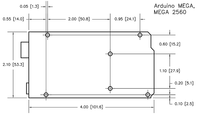

Maybe I just can't read properly, but how do we know what the lateral distance of the bottom right hole is in this schematic?

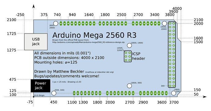

This might help:
Sourced from Nice drawings of the Arduino UNO and Mega 2560
(3.80, 0.10 in case you're wondering)
Yes, it does. Thank you!
