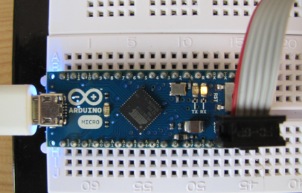

I have a brand new micro that was working fine yesterday. Today I attempted to upload a new sketch to it and received an error. I assumed this was because I had something still listening to the COM port so stopped that and tried to upload again, but nothing happened. I tried resetting the Micro and now the Bootloader COM appears briefly and disappears. I get the following message, USB Device Not Recognized.
I've done a lot of searching online and none of the suggestions on "quickly" uploading a basic sketch while the bootloader COM appears resolve the issue. I got Blink sketch to give me an Uploaded message twice but still no change. Is the Micro now useless? Is there anyway to factory reset this? This is brand new and I'd hate to think it's that easy to make it useless but I can't find any way to get it working again in Device Manager as it was before. I've tried searching for an INF file to manually set the driver but haven't had any luck finding the right driver. I've also tried upgrading the AVR boards in Board Manager with no luck. Using IDE 1.6.7 on Windows 7 (x64).

So I may be stuck having to use the ISP programming method. I'm lucky to have an AVRISP MkII programmer from Atmel at home, never used it though.
Just use the MKII. I have one and it's awesome.
Well I may be hosed. I spent hours last night trying to find the right bootloader and the process for uploading via ISP. I used an Atmel AVRISP MkII and tested using the Arduino IDE as well as Atmel Studio with no success in actually resolving the problem. I even tried uninstalling Atmel Studio because of reported issues with Jungo drivers with no success.
I'm also unable to locate any documentation on what the fuses and lock bits are supposed to be set to for the Micro using the Atmega32U4.
The best I can do is have the device seen as an Atmel device in Device Manager, but this never appears as a COM or USB port for Arduino IDE to see and use again.

Ok, time to fix it now. You are most likely not hosed.
Open the IDE and go into the Preferences and put a checkmark on show verbose output during upload.
Go to the Tools, Board menu and select Arduino/Genuino Micro
Go to the Tools, Programmer menu and select AVRISP MkII
Connect the AVRISP MkII to the Micro's ISCP header.
Connect the AVRISP MkII via USB to the computer.
Connect the Micro to a power supply or USB to computer for power.
Go to the Tools menu and select Burn Bootloader.
At the bottom of the IDE window you will see the 2 avrdude commands that the IDE attempts to run, and the results. Check that they both end without error. If the second avrdude command ends with error, copy and paste the second command in a command prompt window and run it manually. Verify it works ok the second attempt by looking at the output of the command line window.
Disconnect everything.
Connect the Micro to your computer and verify it is restored.
