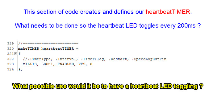

  • Do you understand what we are doing is creating a C++ TIMER object ?
  • It has the name heartbeatTIMER, it is a millis based TIMER, its time-out is 500ms (1/2 sec), the TIMER is enabled and it auto-restarts.
The TIMER is now set to expire every 200ms
makeTIMER heartbeatTIMER =
  //.TimerType, .Interval, .TimerFlag, .Restart, .SpeedAdjustPin
  MILLIS, 200ul, ENABLED, YES, 0

So, it appears that when we create an object called heartbeatTIMER, it has 5 parameters that you list as:
MILLIS, 500ul, ENABLED, YES, 0
Is that correct?
Meaning,
  1. it is MILLIS based
  2. The time period is 500 milliseconds
  3. The timer is ENABLED for now
  4. YES meaning it is to reset after timing out?
  5. 0 means ???
  • Every now and then we need to speed up our code so we don't have to wait for things to happen.
  • Let's say a LED was to toggle every hour.
    There is no way I am going to stay and wait for an hour. (only at the doctors office)
  • The 5th member can be added so a potentiometer can be used to tune/speedup a TIMER.
  MILLIS, 500ul, ENABLED, YES, A4
  • Above, a potentiometer connected to GPIO A4 can be turned to increase the speed that that TIMER runs at.
It's a debugging feature.

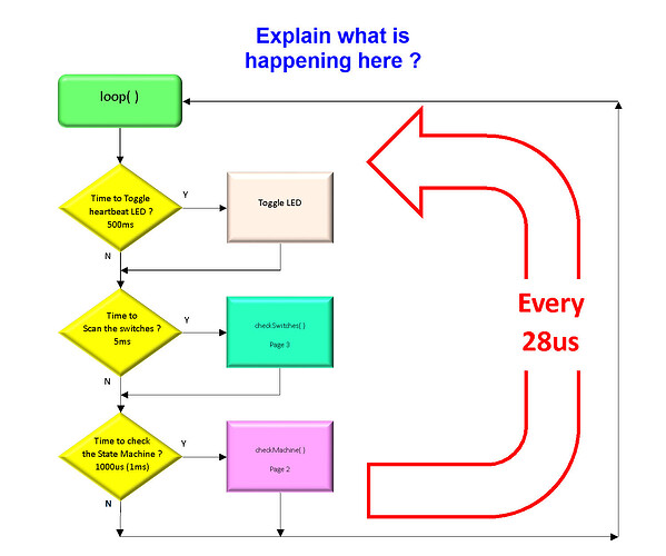

  • Take a look at the loop( ) code in the sketch offered you in Post #17.
  • You should see there are 3 TIMERs that are being examined.
  • Every 500ms we toggle the heartbeat LED.
    Every 5ms we check our switches.
    Every 1ms we service our state machine.
  • Once we service the State Machine, we start things all over again.
  • This all happens in ~28us, the time it takes loop( ) to execute.
  • Yes !
    i.e. 4 TIMER objects.

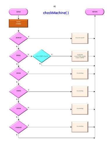

  • Looking at page 3 in the flow chart and at the sketch offered in Post #17 correlate between them.
    Is there anything that you would like explained ?

  • Correlate between the two images below and the code from Post #17.
  • let’s say we push the switch on GPIO D02.
    The code that monitors the switch sees the switch is closed, it turns ON the testLED and initializes the commonTIMER object.
    i.e. it sets the commonTIMER to 2000ms and it starts the TIMER.
    We then make our State Machine go from the STARTUP state to STATE1
  • In STATE1, we check to see if the commonTIMER object has expired, if not, we just leave the State Machine.
    If the commonTIMER object is expired, we disable the commonTIMER object, turn off the testLED and make our State Machine go back to the STARTUP state.
