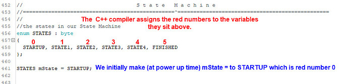

    switch (mState) this asks the question what is mState equal to ?
    case STATE1: says I am equal to 1, do you want me ?

  • If we made variable mState = FINISHED, then mState is actually equal to 5
    mState = FINISHED; //we just put the number 5 into variable mState.

We do it in a line of code, example:
mState = STATE3; //make variable mState equal to STATE3 which the C++ compiler has assigned the number 3

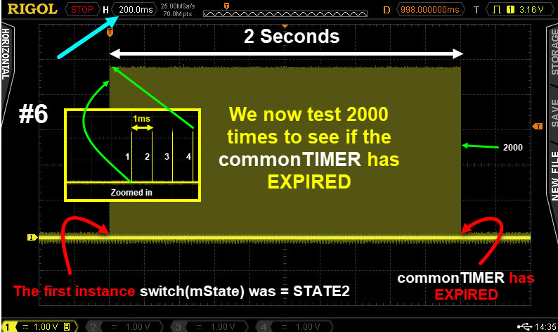

    #6 we get here 2 seconds after power up; then every 1ms for 2000ms (2 sec.),
    then repeats every 8 seconds thereafter.

  • An Oscilloscope trace showing Question #6 results.
  • This image shows us checking the commonTIMER immediately after making mState = STATE2.
  • Looking at the zoomed inset, each vertical pulse is when we are at point #6 in the flowchart.
    There are 2000 checks before the commonTIMER EXPIRES.

//                                    S t a t e   M a c h i n e
//the states in our State Machine
enum STATES : byte
  STARTUP, STATE1, STATE2, STATE3, STATE4, FINISHED
STATES mState = STARTUP;

  • Great, making millis( ) based TIMERs are very easy as you can see, especially when you have a C++ "class" like makeTIMER.
Test Time ( Again ! )
:scream:
  • Well let's see if you can follow my lead.
With reference to the flowchart page from Post #67
  • Below is a new sketch.
  • Add code to STATE2, STATE3 and STATE4 so we get the results as in the flowchart.
  • The code for STARTUP and STATE1 has been added for you.
  • Note: after the 4th LCD screen delay times out, repeat the screen sequence.
enum STATES : byte

        commonTIMER.setInterval(2000ul);
        //start TIMER
        commonTIMER.enableRestartTIMER();
        //next state
        mState = STATE1;
    case STATE1:
        //condition returned: STILLtiming, EXPIRED or TIMERdisabled
        //is it time to go to the next screen ?
        if (commonTIMER.checkTIMER() == EXPIRED)

enum STATES : byte {
  STARTUP,
  STATE1,
  STATE2,
  STATE3,
  STATE4,
  FINISHED
