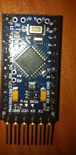

Hello, i have a Arduino mini pro but no USB to FTDI, however, i was wondering whether or not i can use this instead? i will upload a picture. I used a female to Female DuPont wire to connect the pins. i know there are other ways, such as using an UNO and removing the chip and stuff, but i was just curious if this method could work. I used the 5v to connect to the Arduino Mini Pro, tx and rx and Gnd respectively. Your help is much appreciated !

See the pin on your promini labeled RST? That's the Reset pin. Connect a Normally Open Momentary contact switch between that and one of the Gnd pins.
Next time you buy a usb-to-serial adapter, buy one that has more pins (or solder holes). You need one with the DTR signal.
Without the DTR, you have to press a reset button yourself.
It looks as if the board already contains a reset button ?

You don't have to add a reset button if you already have one.
If you enable more compiler and upload output (File / Settings), press the reset button and release it just before or at the same time the avrdude is started.
Sometimes have to press & hold reset, release when IDE says "Compiled xxx of 32xxx bytes".
Sometimes just click reset once when you see that is enough. Depends on what your sketch is doing.
Press & hold usually needed when you used the Rx pin as an output and the PC is trying to send in data.

Hi, i tried reversing the the rx and tx but still no luck =( i even tried to use different pins.. if i hold the RST button, there is no blinking lights at all. is this normal?
Ok this is wierd, i pulled out the VCC from the arduino and the power light is still on?? i pluggd in the Tx and GND only...

hmm ok will give it a go! btw when i connect all tx,rx,vcc and GND, the light blinks slowly....when i remove VCC and RX, it blinks faster..is there an explanation to this?

You have to connect GND, TX and RX.
If the Arduino uploads a sketch, it communicates with the Arduino board, and data is read and written.
Some manufacturers print the label 'TX' for the transmitter pin, connect that to RX and vica versa.
Some manufacturers think they are smart, and print the label 'TX' to notify that the 'TX' of the Arduino must be used.
So you will never know how to connect TX and RX, try both ways.
hello guys, i tried the rest method and it did not work as i planned, so i got the ftdi from ebay http://www.ebay.com/itm/320907184616?ssPageName=STRK:MEWNX:IT&_trksid=p3984.m1439.l2649 it worked fine! realised that the rx and tx are inverted though. i have to use the FTDI board backwards in order for it to function.
you were right lol thanks a bunch!
