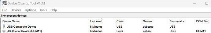

Then you'll have to run this program "As Administrator" then you'll see a typical screen like this
This was for my PC, where my MKR ZERO was connected to it as COM11 (6 minutes ago). You see that there are actually two USB items that you need to delete; a USB Composite Device and a USB Serial Device. Just right-click them with the mouse to delete them.
Lastly, reboot your PC and log back in. Then when you re-connect the MKR ZERO to your PC, Windows OS will reinstall back the proper drivers and settings for your MKR ZERO (as it was for the "first" time), and Arduino should behave as "normal" again - hopefully :grinning:
