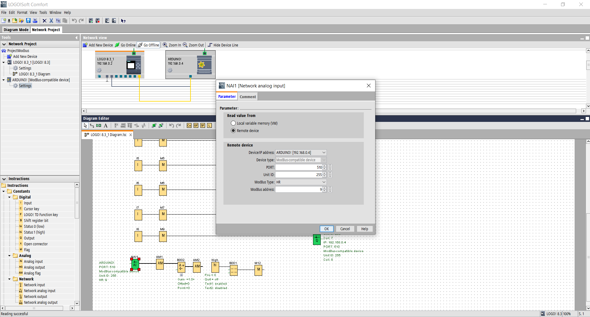

Hello guys, I am trying to connect arduino mega with ethernet shield to SIEMENS LOGO! plc via the modbus protocol, using the ArduinoModbus library.
I need help from someone who has more experience with this protocol. I already meke the Modbus slave with eight outputs. It works fine but after i reconnect the slave or shut down the power source or if i press reset button, communication breaks and it will never ever start again. I have to upload a program and then it works. Nothing else helps (reset, shut down and turn on, reconnect ethernet cable) I have to upload the arduino program again....
The second problem is that I am not able to transfer data from the arduino into the plc. I tried a lot of different ways and adres.

And now about the connection with plc. I am not sure if it is the right method to connect these devices together. But I am using NetworkOutput with a manually defined address.
I also set an input manually because no one of the output registers works via the modbus connection table of the arduino.
So I know that MODBUS uses an IP address and port to connect the device but I am not sure how this modbus address works. You can see in my program that I made 8 coils which start with address 0x00
if i understand it right, it means that I created Coils at adresses 0x00 - 0x07 each one, one bite.
I don't know why but there is an offset (by 1) in the modbus address, so if i want to call 0x00 i have to call 0x01. I used address from 1 to 8 in siemens plc to connect outputs located on address 0x00 - 0x07
After I added a holding register to address 0x08 I am not able to read them in SIEMENS PLC.
So 2 main problems:
Works only after fresh uploaded software.
Holding registers are not accessible from PLC
