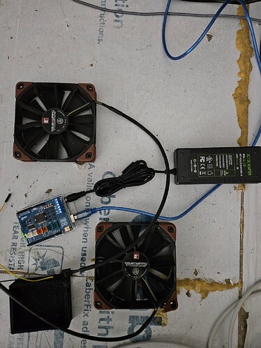

OK sorry newb here but am looking for a few basic details. I have the above board sat on my Arduino board. My project is fan controllers for my racing sim rig.
I have 2 120mm PC fans with 3pin connectors, ive been unable to work out or find a diagram which gives the details on all the connectors on the Motor shield board. Can i connect these fans to the board to one of these connectors, i have ordered some Dupont connectors in case i can't.
Also the arduino uno is currently plugged into a substantial 12v 3A supply will that power these outputs also via the joined connections?
Any tips appreciated! I am using Simlab software which i believe has various Arduino profiles already.

Thankyou so much for replying but this isn't my board, mine looks like this which is sat on top of the arduino uno. I have a 12v 3amp supply plugged into the Arduino Uno board which i believe feeds power via piggy back pins power into the Motor shield board powering that also?
See the Rev3 schematic diagram here for my Motor shield board.
I intend to control 2 120cm fans visible in the photo
Here is a photo of what i have so far.

Woke up thinking about this, my fans are 4pin and this is all about varying the speed as this for Simhub a driving sim so the wind speed varies.
Therefore we need to control the fan speed via PWM. So thats 3 connections.
Well, that would make things quite different, and you don't need the motor shield.
In principle, you can connect the fan PWM to any Arduino pin that supports PWM. However, the stock code may not output the right PWM frequency; a particular frequency may be required.
Here is a project that does this ; 25 kHz 4 Pin PWM Fan Control with Arduino Uno | Arduino Project Hub
I believe it's the other way around.
Anyway, not needed with 4-wire fans.
