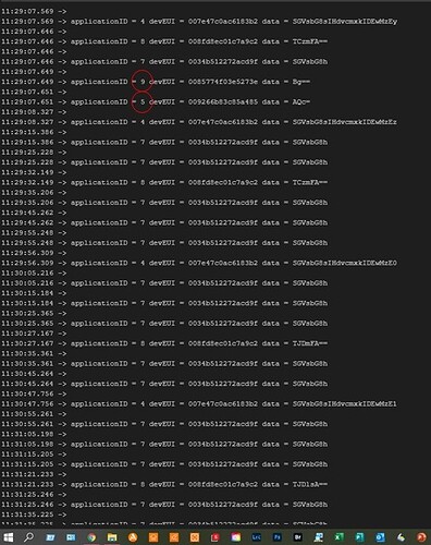

Hi. I have 6 test nodes up and running. My arduino MQTT client subscribes to my RAK7249 gateway. I receive messages from all 6 nodes. Goes well. However, I have turned one node off (node 9) and I have set node 5 to only send a packet when there has been a change from the last packet sent. There could be as long as 6 months between sending packets.
However, my Arduino MQTT Client regularly sees nodes 5 and 9 and reports messages from them. How can I stop these daed message, please.

Are messages actually being sent or is the problem in the Arduino code ?
Perhaps but not limited to:
If the MQTT Broker has its persistent setting to true, then the last data sent will be available to any new client attaching. Persistence can be disabled. When persistence is disabled the MQTT Broker presents to its clients a NULL at initial connection. It is the client's responsibility to handle the reception of NULL payloads if persistence is disabled.

Here is the output.
Node 5 is powered up and in service, but it only sends a packet when the mains/grid fails which tends to be about 6 times per year. The node reads the state of the grid every second, compared wirth the previous reading, and if changed, send s a messhe to thje gateway and then to the MQTT.
Node 9 is powered down just now. Not working, not in operatipn. not sending. However, it was going 9 days ago.
With regard to "presence", the RAK7249 dateway is set to Qos = 2.
Idahowalker
I've got a feeling that the two instances I ringed in red in the output are (i) the last data sent (albeit x days ago) when the MQTT is reset, ie initial connection, and (ii) the data associated with node 9 is a NULL while for node 5 (state of the grid) it is "7" representing 3 energised relays, ie bits 0,1,2 all set to 1.
I can solve node 9 by testing for the NULL. I can let node 5 transmit all the time ie every 1-second, and do the change of state testing in the loop of theMQTT. That will guarantee that there is a continuous connection to the gateway for that node, but will use up transmission time,

Than you, all. I have been commissioning solar, so the mains has been on again, off again, many times in a day. I rebooted the RAK7249 gateway and problems went away, after I’d incorporated NULL messages into my code. Node 9 which is not powered up disappeared. Node 5 which monitors the solar/grid failure only shows up at MQTT start time. Thank you again.
