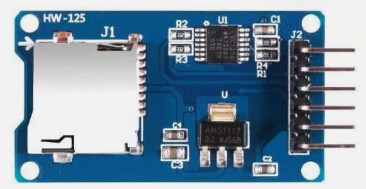

Despite @JohnRob 's concern, there should be no problem with this board sharing the SPI bus with other devices. The MISO pin does not connect to the 74hc125, it connects directly to the header pin.

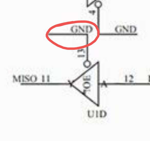

You are 100% correct. My issue was my system included a M31855k board which is also SPI.

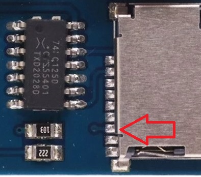

Because the Deek-Robot sends the MISO directly to the connector, it is not tri-stated. The MISO being not tri-stated conflicts with the M31855k MISO.
No. If MISO is connected directly to the SD card, the SD card will tristate the line unless its CS pin is asserted. So MISO will behave properly this way. The direct connection is the same on the Adafruit SD card module, and it plays well with others.
So I think the problem must be something else.
Ah yes, your statement is correct. Your post jogged my memory.
A while ago I was trying to use this board:
For reasons that still escape me they passed the MISO through U1 grounding the CS for that channel. This is not a problem until there is a 2nd SPI in the system.
The board is powered with 5V and supposedly the design was to allow an SD card to work in a 5V system.
Yes, it seems such a simple slip, I wonder why a V2 is this board wasn't developed to fix it.
That's the problem. If that enable pin was connected to the CS pin instead of ground, I wonder if that would fix it. But it would not have translated the 3.3V MISO signal to 5V because the 74VHC125 is powered by 3.3V, so perhaps no better than simply connecting the MISO directly to the MISO pin, bypassing the 74VHC125.

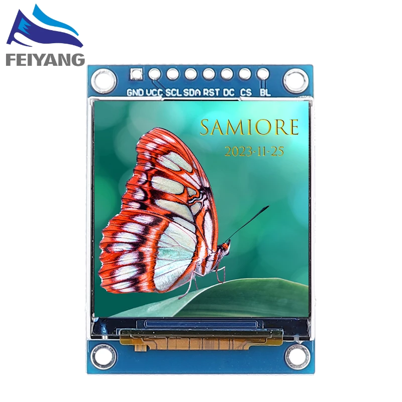

Back to the OP's connections. I'm not an expert at I2C but shouldn't ALL the SCL and ALL the SDA's be on the same pins
Yes, but the headers of the display module are wrongly named. They are actually SPI lines, so I think they are correctly connected. Plus, the OP said both the display and the SD card work fine when only one is connected.
