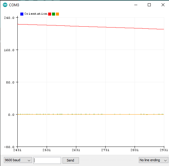

Hi, I'm using IMU in Arduino Nano 33 IoT to get the heading, pitch and roll using the MadgwickAHRS library. When I lay the board flat on the table, the pitch and roll gives consistent value. However, the heading keeps decreading linearly even if the board is not moving. Here is the code:

I've attached the Serial Plotter output. How do I fix it so the heading can have consistent output?

disclaimer: Not sure if it's related and I've never used that arduino...
Is there a way to look at the gyroscope biases ? if they are too high it results in a constant drift of the Yaw output. (read more about Manual Gyro Bias Estimation)
