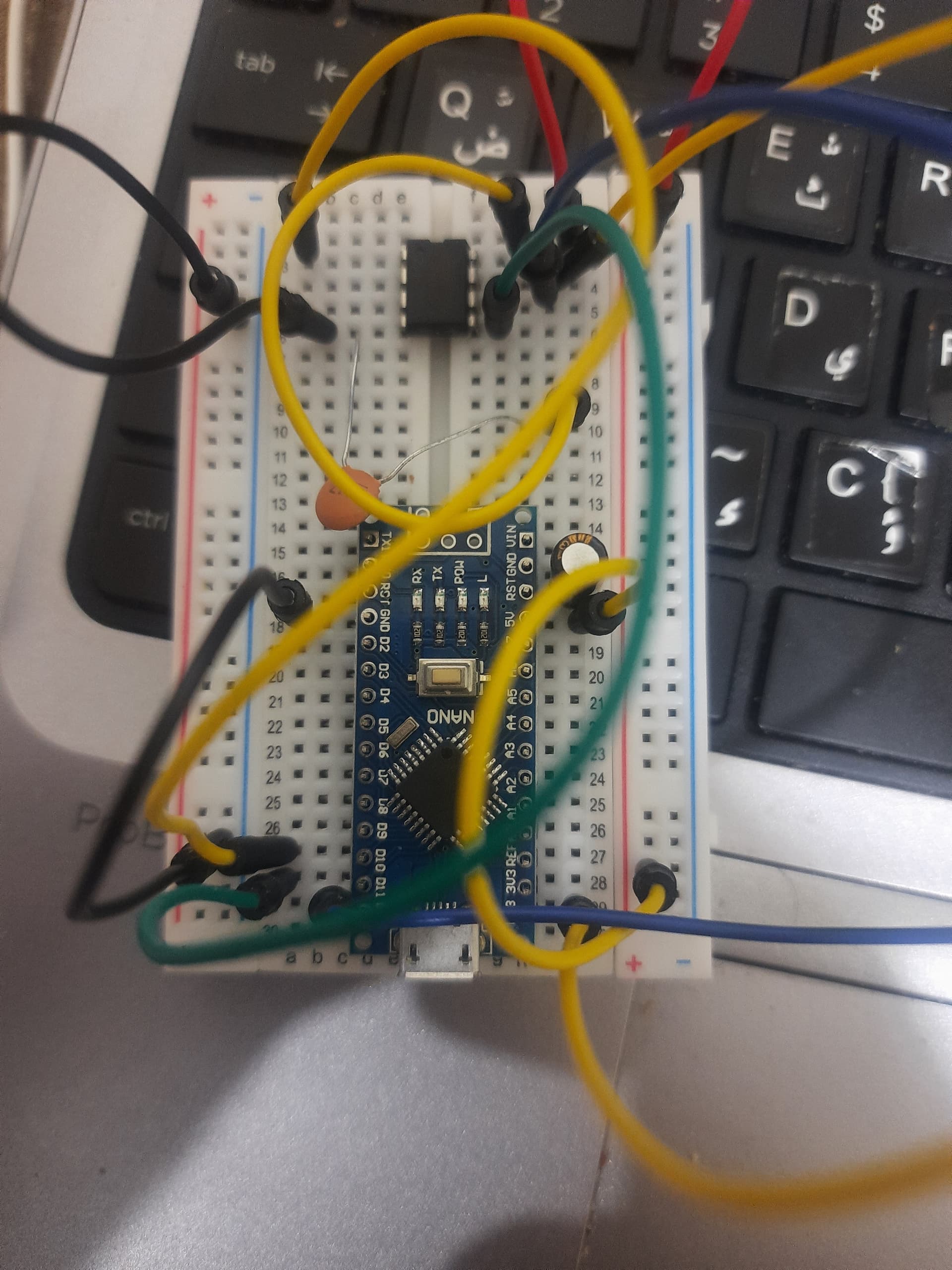

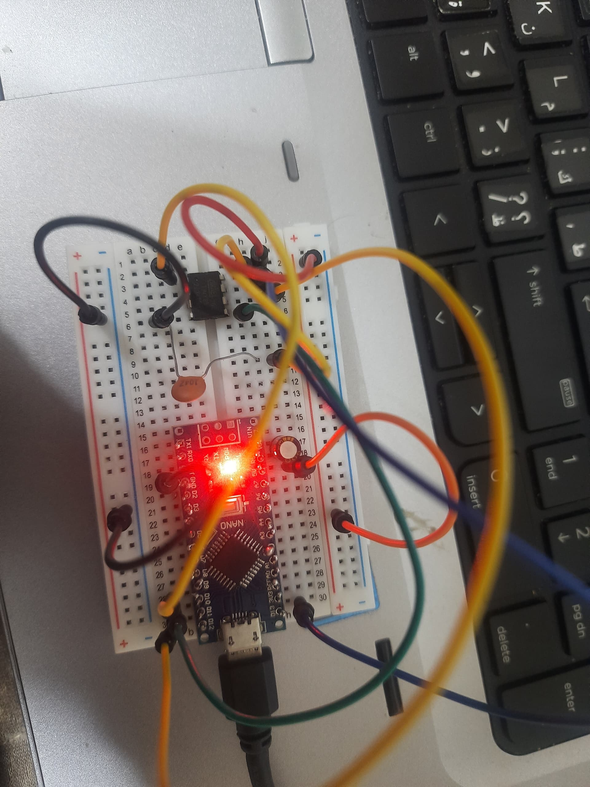

Can you show is the wiring please.
Iam sure my multimeter is working
5V - PIN 8
GND - PIN 4
D10 - PIN 1
D11 - PIN 5
D12 - PIN6
D13 - PIN 7
capacitor 10uf between gnd and reset of arduino
capacitor0.1uf between vcc and gnd of attiny

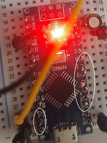

Solder.
Just sticking header pins in the holes is highly unreliable.
I solder it and now i can see 5v but still same

I'm afraid that soldering job is nowhere near good enough.
Adafruit had a good tutorial on Making a good solder joint. It would be worth your while to review it and use the techniques that are shown there. It will make your life much, much easier.

And …. Don’t forget on some prototyping boards the supply rails are not continuous along their length

Have you individually tested the jumper wires? Those have been known to break inside the insulation where the end pieces are crimped on.
I would go back to using the UNO to completely eliminate the possibility of a problem with the soldering. If you want to keep using the Nano, I would check the connections by measuring the resistance between the pins of the attiny85 and the ICSP connector on the Nano, that will have everything except the line to pin 10, and let you know if the solder connection and wiring is good.
Sorry but those solder joints are nowhere good enough, most of them aren't even connecting the pin to the PCB.
Spent some time with your soldering iron and let the solder melt over the joints.
What solder and soldering iron do you have?
Well the results are plainly showing that they probably aren't good enough to work.
