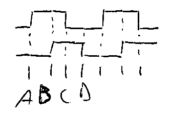

My suggested code performs the same logic (I hope). My code may be less efficient because it uses digitalRead(), but it will run on Nano Every, and other types of Arduino, not only atmega328.
Yes. The code you copied used pin-change interrupts, which fire on both rising and falling signal edges. CHANGE is the equivalent for external interrupts.
I'm not sure. My suggested code uses digitalRead(), which is slower than direct port manipulation. But my code is simpler, and simpler is often faster, and external interrupts can be faster than pin change interrupts, so maybe both codes run at similar speed. But this only matters depending on the speed of your motors and the frequency of the interrupts generated by your encoders. Maybe either code will be fast enough. Over to you for testing.
encoder
Going from left to right:
A: Rising, other low
B: Rising, other high
C: Falling, other high
D: Falling, other low
All combinations need to increase the value. I think you oversimplified your code too much.
Yes
Please explain. Which edges do you think it will miss?
For case B and D the code is decreasing encValue. I think when xxBPin changes, the logic needs to be inverted.
Ah, ok, do you think the code in post #7 has the same problem, or only the code in post #8?
Yes. The fix is easy. In encLeftBInterrupt() change the first comparission from HIGH to LOW.
The same for encRightBInterrupt().
