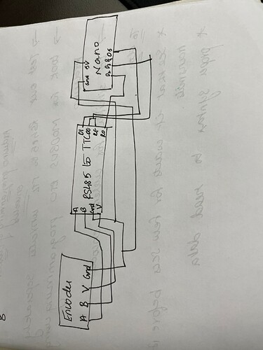

Can you show a schematic - hand drawn is fine - of how you have connected your Nano, MAX485 and encoder together.
HI, this is the schematic
I also tried exchaging RO and DI but still no luck
You shouldn't need delays in the preTransmission and postTransmission functions.
In your call to readHoldingRegisters, change the 2 to a 1, as you want 1 register.
What are the power requirements of your encoder?
Do you have a USB-RS485 dongle?
