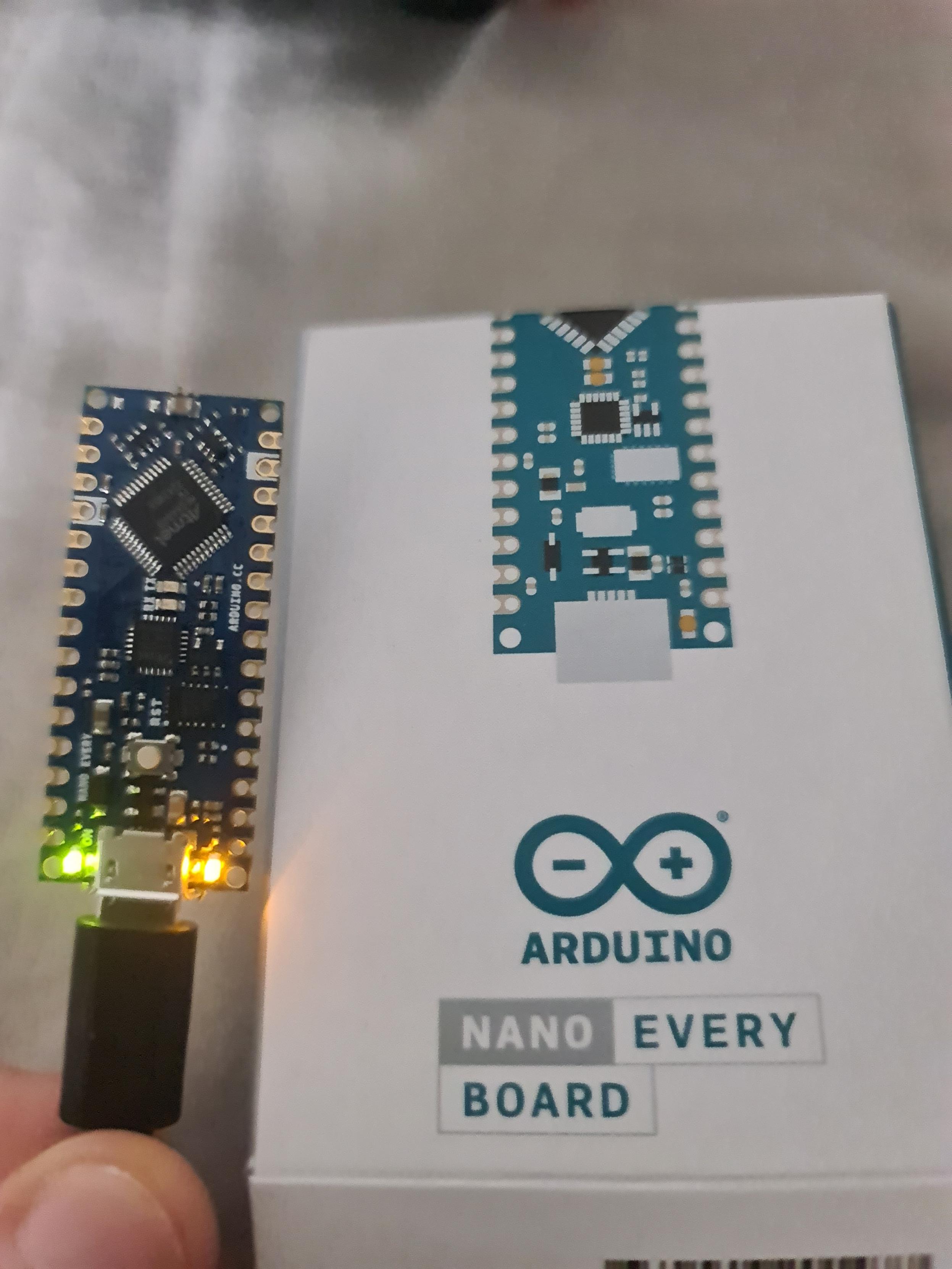

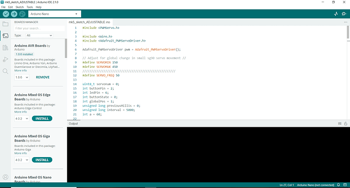

I got my first arduino (nano) a few days ago but I can't put any code on it.
The "port" category is grayed out and cannot be selected.
My arduino is well connected (continuous green light and a flashing orange).
When I try to upload, I get this error :
Failed uploading: no upload port provided

no driver installed for your particular board
If you have official Arduino nano, just install IDE 2.1.0 and all the dependencies that show up after the installation. After this, use a good data USB cable(very important) to connect the board to your PC, the new IDE will auto detect it.
But if your board is a clone, make sure you install the right driver for it, like https://www.instructables.com/Arduino-Nano-USB-Not-Recognizing-Fix/
I normally have an official version (the box looks official anyway).

show pictures of the board

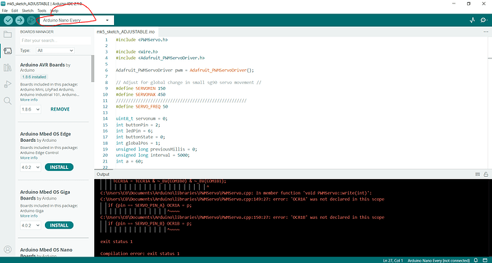

I think I have a lead.
I just noticed that there are arduinos nano and every nano.
So I tried to select every nano.
But now the code does not compile anymore, I have the following errors:
C:\Users\CB\Documents\Arduino\libraries\PWMServo\PWMServo.cpp: In static member function 'static void PWMServo::seizeTimer1()':
C:\Users\CB\Documents\Arduino\libraries\PWMServo\PWMServo.cpp:44:3: error: 'TCCR1A' was not declared in this scope

TCCR1A = TCCR1A & ~_BV(COM1B0) & ~_BV(COM1B1);
C:\Users\CB\Documents\Arduino\libraries\PWMServo\PWMServo.cpp: In member function 'void PWMServo::write(int)':
C:\Users\CB\Documents\Arduino\libraries\PWMServo\PWMServo.cpp:149:27: error: 'OCR1A' was not declared in this scope
if (pin == SERVO_PIN_A) OCR1A = p;
C:\Users\CB\Documents\Arduino\libraries\PWMServo\PWMServo.cpp:150:27: error: 'OCR1B' was not declared in this scope
if (pin == SERVO_PIN_B) OCR1B = p;
exit status 1
Compilation error: exit status 1
You don't have a Nano, you have a Nano Every. You will need to install the megaAVR board package.
Regarding your error messages during compile, not all 3rd party libraries will work with the Nano Every. PWMServo is probably one of them.
yep, I just did it but still errors
OK, that screenshot from post #10 is fine. I did edit my previous reply adding some additional information.

Your conclusion is wrong; probably a charge-only cable. Get a cable that you can also use to download files from your phone to the PC (it's called a sync cable or data cable).
thanks for your help, the problem was indeed the cable that did not send the data (but I still have my compilation problem, I'll try to search by myself)

But for the board, I tried the 8 (I don't know which one to choose)
Here are my outputs if it can help:
Using board '808' from platform in folder: C:\Users\CB\AppData\Local\Arduino15\packages\MegaCoreX\hardware\megaavr\1.1.2

c:\Users\CB\Documents\Arduino\libraries\PWMServo\PWMServo.cpp:118:43: error: 'COM1B1' was not declared in this scope
c:\Users\CB\Documents\Arduino\libraries\PWMServo\PWMServo.cpp: In member function 'void PWMServo::write(int)':
c:\Users\CB\Documents\Arduino\libraries\PWMServo\PWMServo.cpp:149:27: error: 'OCR1A' was not declared in this scope
c:\Users\CB\Documents\Arduino\libraries\PWMServo\PWMServo.cpp:150:27: error: 'OCR1B' was not declared in this scope
Using library PWMServo at version 2.1 in folder: C:\Users\CB\Documents\Arduino\libraries\PWMServo
Using library Wire at version 1.0 in folder: C:\Users\CB\AppData\Local\Arduino15\packages\MegaCoreX\hardware\megaavr\1.1.2\libraries\Wire
Using library Adafruit PWM Servo Driver Library at version 2.4.1 in folder: C:\Users\CB\Documents\Arduino\libraries\Adafruit_PWM_Servo_Driver_Library
exit status 1
You should use the 4809 on top in your screenshot, that is the processor on your Nano Every.
But the library that you use will not work on it because it directly accesses the processor hardware without considering which processor family it exactly is. So you need to find a library that has support for the 4809. Or raise an issue with AdaFruit.
After you select the 4809 board, you will need to check the Nano Every pinout.
You can not use the PWMServo.h library with the Nano Every. Use #include Servo.h.
