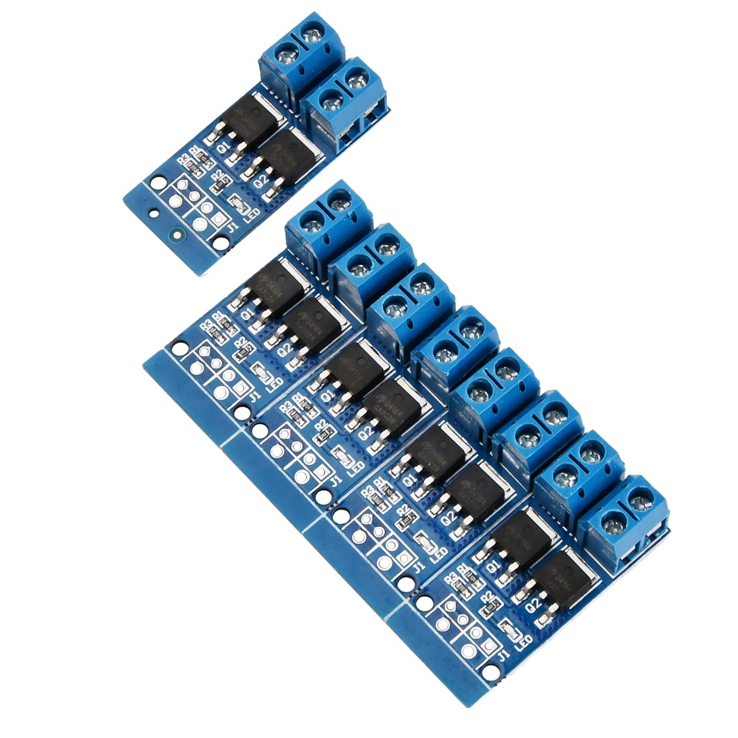

It's an IRFZ44N... I know it has a VgsThresh. of min. 2V - max. 4V so it's barely fully saturated at 5V output and the gate resistor. Should have used IRLZ44N... However, I'll get small mosfet driver modules today with a VgsThresh. of min. 1.7V - max. 2.7V.
You are proving that the IRFZ44N is not doing the job.
Get a Logic level MOSFET and that will work better.
What driver modules?
Tom.. :grinning: :+1: :coffee: :australia:
they are using this mosfet:
They've just arrived. I wired them up and voilà.. they work perfectly. So it really was a matter of getting the right mosfet for the job. :grin:
