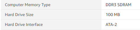

Would you trust a boost converter where the seller gives technical details such as
I was actually looking to see how much current it could supply when I found that gem
