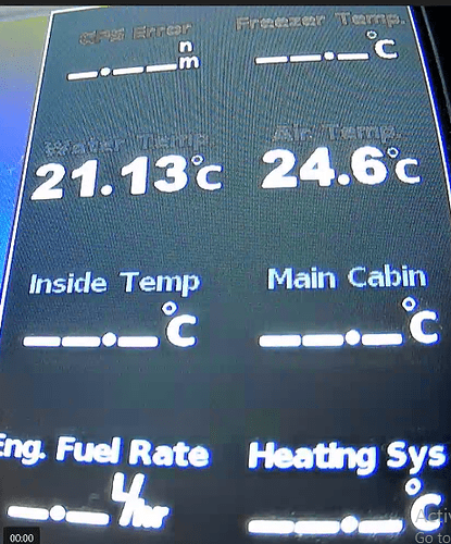

Arduino Not sending PGN 130312 Temperature Data ON NMEA2000 ON GARMIN 720S

here is the code which i used to send data on bus is attached, environmental outside temperature and air ambient temperature which is PGN 130310 , shows on GARMIN 720s,but PGN 130312, and even 130316 is unable to show on Garmin.
Issue is solved by adding required pgn only and soft reset on Garmin
