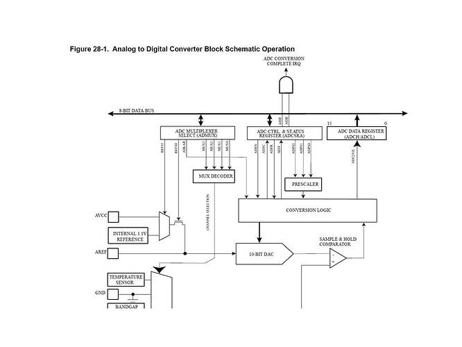

Thank you for your suggestions. I added the .1 pf capacitors and found that if i remove the jumper wire from "Pin 21 - AREF - Analog reference pin for ADC" that everything works. What is this particular pins purpose? Why do the directions include this? If you can explain I would appreciate it.
Can someone please explain the ADC AREF pin issue to me I don't know what it is for and why it disables my chip when hooked up to the 5v rail.
It is connected internally thru a mux - when you connect 5V to it can damage the mux depending on the settings selected.
Bottom line - don't connect Aref to 5V externally, that is already one of the internal selections you can make.
