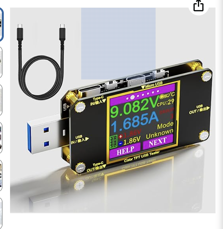

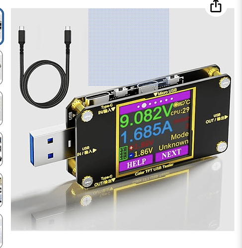

For the main 5V feed. For USB I have a meter that plugs into the USB socket, for the wall wart if it ends in a USB then use the same thing, otherwise use a VOM. Here is a sample on Amazon.ca. Get one or more depending on USB version. I have USB-A to USB-C converters.
https://amz.cx/3RVD
