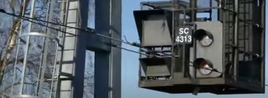

After watching a lot of UK RAIL Videos, I have come across this, what seems to be getting bigger, but being compared with Ladder on the left, it may be over 12inches or 300mm square, anyway I may have someone kind enough to go back to where THEY took their videos and do some measuring for me.

What is that gantry thing, I don’t see any displays there, other than the two possible lights (circles) at the right.

HI Lastchancename,
this PICTURE shows, on the left a Safety Ladder, on the right there is 2(maybe 1, 3,4) Round lights that were up until recent times the NORM for Signals the LARGE BLACK SQUARE is the NEW VERSION of INDICATION or SIGNAL that is ahead, there is another BLACK BOARD. smaller, I am not sure what this one does, what I plan to have this bigger one, with all the (depending what Number of LEDs(6 across and6 down = 36 x0.75, (or 5x5=25))) 0.75mm Fiber Optic inside a square or oblong pole to go through the layout to a PCB Board and 3mm leds that will get instructions via a MEGA
hopefully near the HO SCALE (3.4mm=1foot) as possible, but seeing it will be MY LAYOUT I could live with a little bigger, will have to wait and see how I go in getting all THIS LITTLE STUFF together and have it WORKING with numbers that will indicate one of 10 points ahead, so that this board will show 0-9 or it might 1-0 to represent one of these points.
