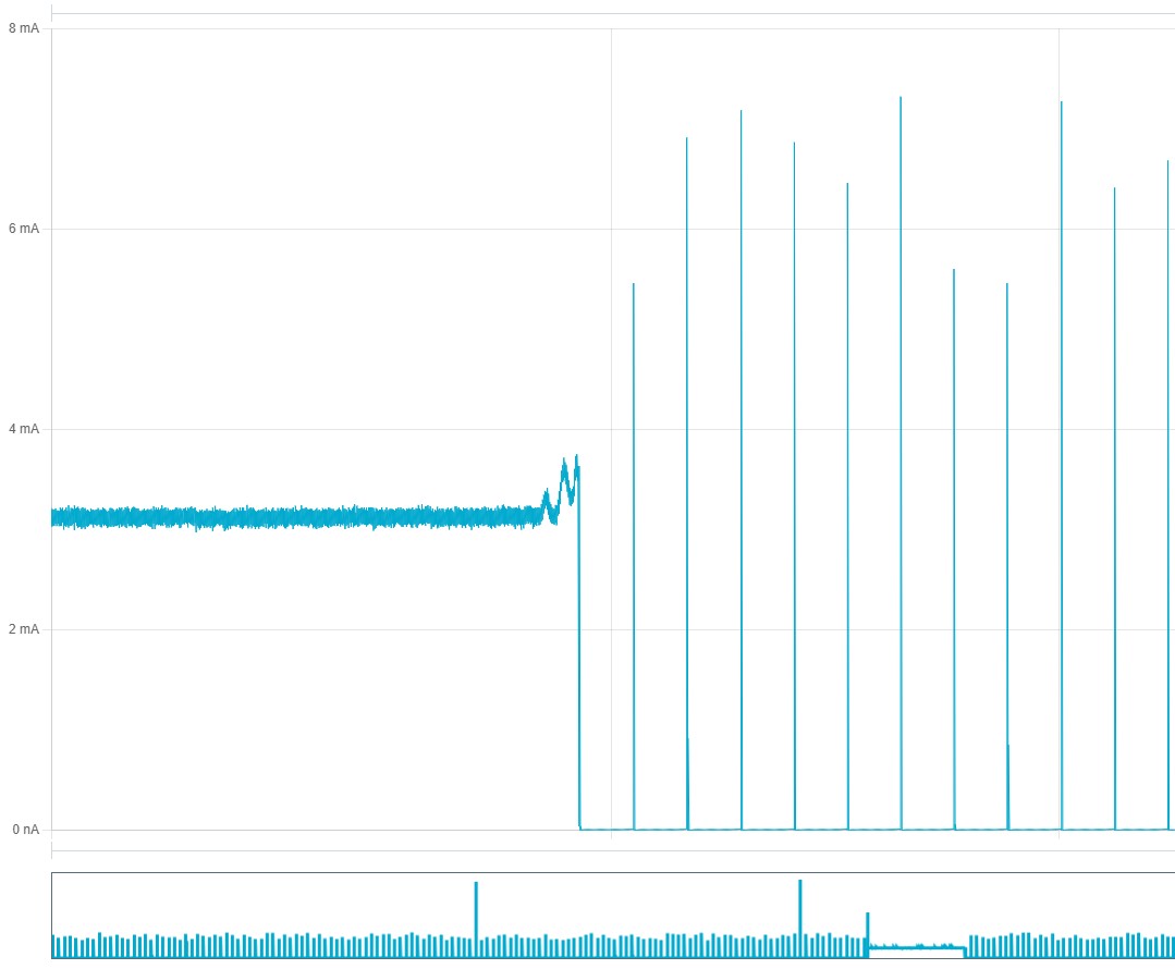

I'm investigating low-power mode on a Arduino Pro Mini 3.3V / 8MHz module. I'm using the LowPower library on a basic sketch to power down the Arduino for 8 sec and then have it running idle for 1 sec like so:
#include <LowPower.h>
  LowPower.powerDown(SLEEP_8S, ADC_OFF, BOD_OFF);
I removed the power LED from the board and feeding 3.3V into Acc pin. I did not remove the (unused) onboard linear regulator. Basically I was following How to modify an Arduino Pro Mini (clone) for low power consumption and expected similar measurements. No serial attached or used. Bare bones module.
What I'm getting is
  • The expected current consumption of ca. 9uA
  • about every 25ms, a sharp current spike of ca. 6mA!
Any explanation?
This shows the transition from idle to powerDown and the mysterious spikes:
may be the watchdog still requires some cycles from time to time ?

The spikes occurring every ~25ms suggest the Watchdog Timer might be firing.

25ms is 40Hz. Does that fit into the way the WDT works?
Anyway, load this code into your Pro Mini, and see if you still get the spikes.

Thank you everyone for their suggestions! I figured it out - it was the onboard voltage regulator. After desoldering, the sleep power is down to a stable 5uA.
I couldn't believe at first that a seemingly simple component as a linear regulator could cause such stable periodic power spikes, but it seems true.
This also proofs that the simple use of the LowPower library (see my original post) is sufficient, no additional code needed.

Note that I fed 3.3V into Vcc pin, leaving RAW unconnected. I guess the chip doesn't tolerate voltage on output but not on the input.
I was surprised myself, not expecting such precise spikes (they looked very digital) but removing the regulators fixed the problem, proven in 4 cases at least by now.
Maybe it charged (regulators often have a reverse biased diode) the Vin capacitor and when it was charged, the regulator made an attempt to spew that voltage out. :person_shrugging:
