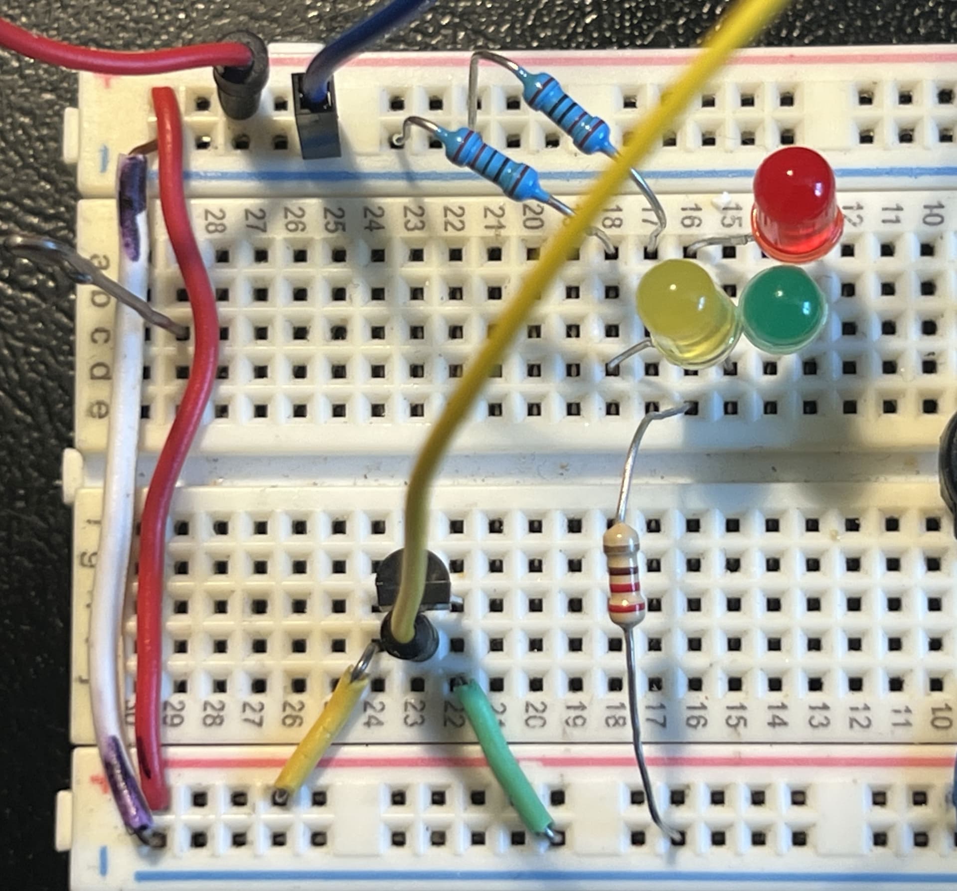

@janosch1 has may well have destroyed any transistors that were ever part of a circuit that connects it directly across the power supply.

So, what is the conclusion of the panel? What should I do next?
I suggest you find the black 3 legged thingy that has tmp written on it...

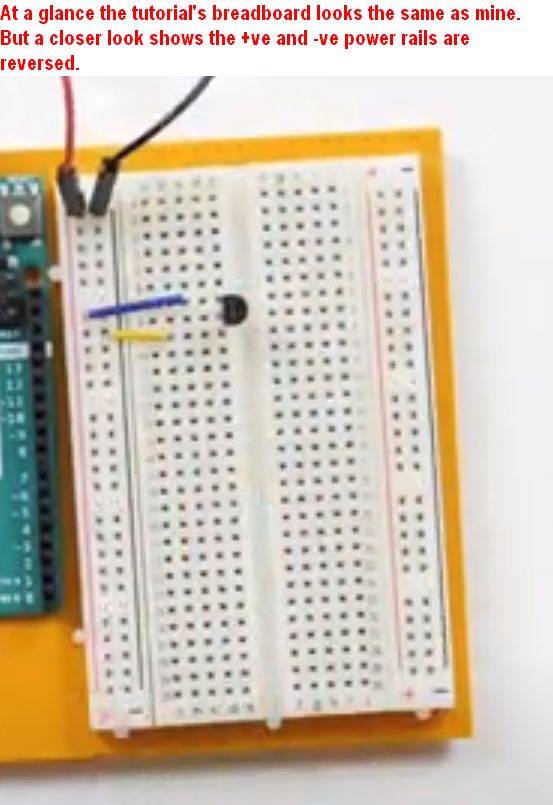

My TMP 36 arrived and the sketch works exactly as it should. Room temperature matches the 25.7 of an accurate thermometer alongside.

I'm guessing I know why it didn't work for you.
When I first ran it I got almost identical results to yours, clearly wrong. I was sure I'd wired the sensor pins exactly as shown in the video tutorial. But a closer look revealed a crucial difference: the power rails are reversed. See the comparison below, with mine now correctly wired.
(Note: I didn't bother to complete the LED wiring after testing them during the earlier discussion.)

@build_1971 Sorry mate. There is nothing in my kit like it with 3 pins. This must be the TMP.
What is 'this'???
The thingy with BC547 (on your photograph) is definitely not a tmp...
@build_1971 they misted to the TMP in the kit. You are right! It is marked with name

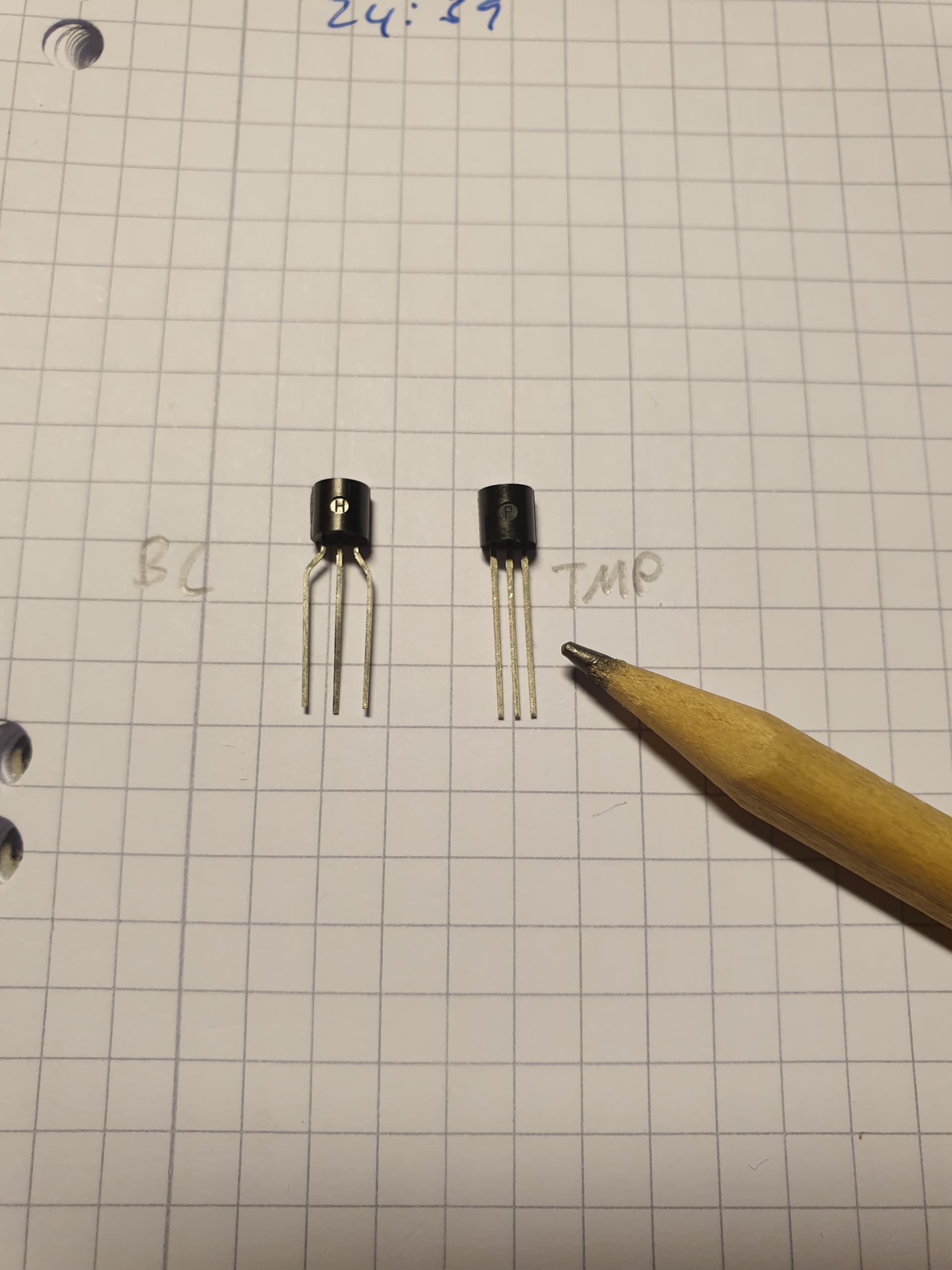

BCS47B
@build_1971 Its is transistor, like @oqibidipo showed in his post#39
BC547
Not S
It is one of the most common transistors...
Often together with its brother bc558 (or something close to that).
@build_1971 but you know what is def confusing? The TMP what @Terrypin is using and shown in his recent uploaded image, its looks, shape from above, absolute identical. :slightly_smiling_face:
Yes! Indeed! BC547 sorry! :grinning:
That is a standard housing...
There is maybe 20 common types of housings.
They are listed here:
https://www.matidavid.com/electronic_components/04.htm
@build_1971 I have found something. IRF520. Could be that the TMP or should the word TMP printed on the sensor?
No, that is a mos(?)fet.
Google is your ftiend...
Gotcha! Cheers! :smiley:
YES! I found the TMP! like in the post#39 from @oqibidipo. Amazing!
:partying_face: And guess what, the housing is the same as the BC547.
