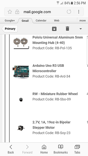

Im trying to build a project and need some guidance about all the electronics i need to purchase.
The project consists of
2 stepper motors
2 bidirectional flex sensors
1 arduino
The idea is simple ... when the flex sensor(s) is pushed
The stepper motor(s) will turn in the direction it is programmed to.
The project needs to run Standalone with batteries
Ive already purchased a few items to get started
But i know i am missing some electronics still.
So im askimg for help on here hopefully someone could point me in the right direction to what else i need to buy so i could get started .
I will post the list of what i already bought in the attachment

Please post links to the items you are thinking of purchasing?
Can you please tell us your electronics, programming, Arduino, hardware experience?

Can you also tell us what you are trying to make or give us the link to what looks like a Hackster project you for those screen dumps from.

Ive posted pictures earlier in this thread describing all the items which i already have
