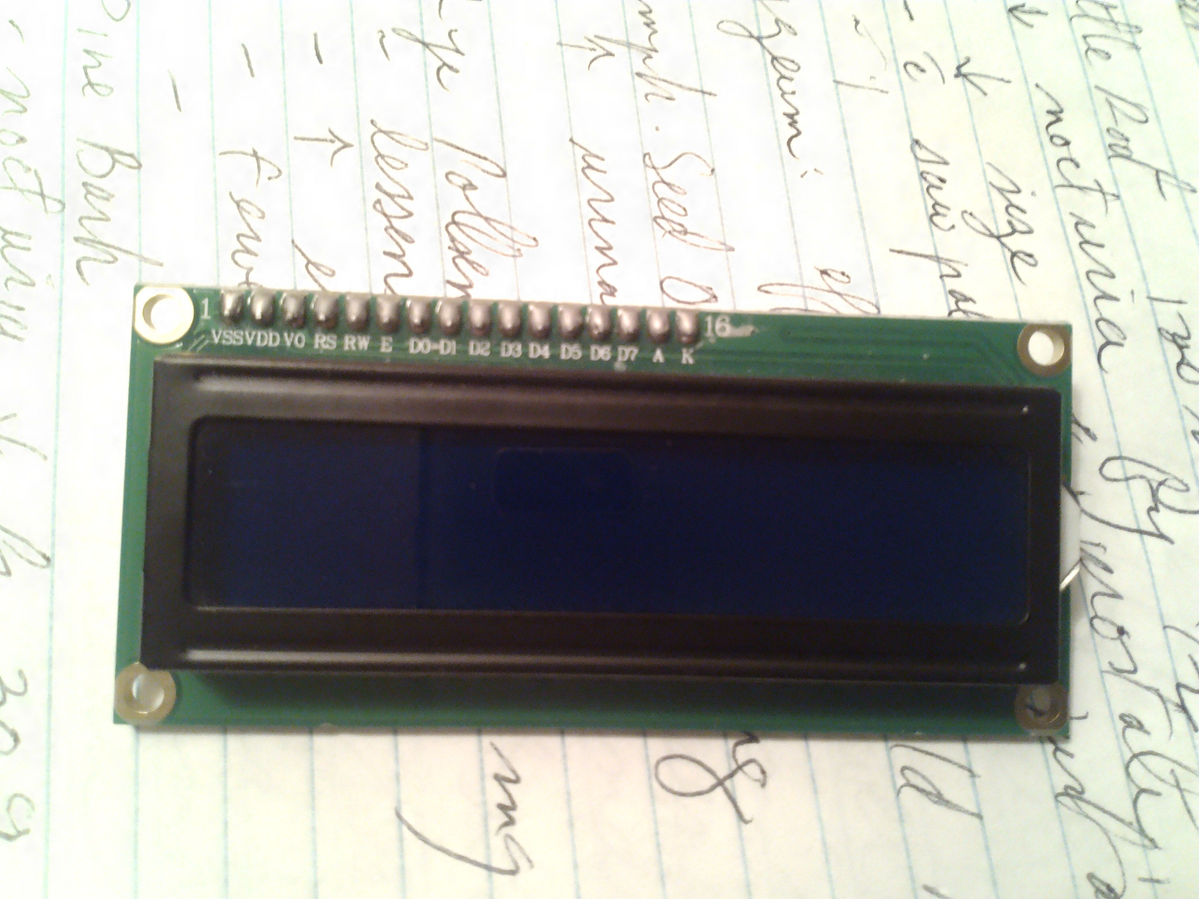

The first thing is, I don't understand what a code block means.
I copied and pasted the sketch from the book, and I have verified that all the required libraries are installed.
This morning when I went to repeat the test, I did not get any error message, just the fact that nothing appeared on the LCD display.
I've included screenshots of the sketch and the breadboard setup.
Thanks again for all the help.
Instructions suggest that you have a wiring problem.
Alternatively, do you have the same LCD as is used in the code/libraries you are using?
Can you include a photograph of your hardware please.

Here's the photo of my actual breadboard setup. Realize that the LCD illustration in the book is the mirror image of my setup, i.e., numbers 1 to 16 run in the opposite direction.
Another thing that doesn't make sense to me is the display on the LCD doesn't change at all when I go from one end of the 10K pot to the other! I've never had that happen before. I even tried several other denominations of potentiometer, but they'll do the same. Thanks for all your help.
The wiper on the pot is supposed to go the Vo pin. In your photo, it appears to be going to D7.
In your LiquidCrystal constructor, you have specified pin 12 to be RS, and yet it goes to D6 on the display.
You have also specified pin 11 to be E, and yet it goes to D4 on the display.
You have grounded D5 on the display.
You have specified pin 5 to be D4 (d0 in the constructor), and yet it goes to E on the display.
You have specified pin 4 to be D5 (d1 in the constructor), and yet it goes to R/W on the display.
You have specified pin 3 to be D6 (d2 in the constructor), and yet it goes to RS on the display.
You have specified pin 2 to be D7 (d3 in the constructor), and yet it goes to Vo on the display.
On the bright side, you did hook up Vss and Vdd and the LED backlight properly.
In wiring up my LCD I followed the text in the ebook. See the photo.
As I tried to explain last time, the numbers 1 to 16 on my LCD run from right to left in the photo of my breadboard. But if I follow the directions in the book, the LCD in the picture in the book would have to be numbered in the opposite direction.
Am I to understand that I should just ignore the numbers 1 and 16 on my LCD and wire it according to the picture in the book? Thanks for clarifying this.
Yes, and I didn't understand that the first time you said it. Why do you think this? Is it because the pin labels are upside down, as you look at it.
I think that is where you are going wrong. You are getting hold of the "wrong end of the stick" so to speak.
You need to wire it up according to then physical layout diagram Figure 0708 and check it against the schematic in Figure 0709.
Yes Mike, as I look at my LCD in my photo, the numbers 1 and 16 are upside down.
I did rewire the LCD according to your instructions, and it did work the way it was supposed to.
Too bad the schematic wasn't included in the text, as it generally is. Cuz I do normally double check my setup against the schematic. Here you have to go to the website to download it, and then the printing is so fine that you need a magnifying glass to read it!
My lingering question is, is there an error in the text, or are these LCDs numbered from left to right or right to left, depending on the manufacturer? The ones I got seem to be a no-name brand that I got in my Elegoo super starter kit, and also in their sensor kit.
Thanks again for your help.
No they are the same.
One thing you are forgetting is that the way the board is wired up on the physical layout diagram is upside down. Which gives you the impression of it being numbered backwards.
Glad you got it working.
