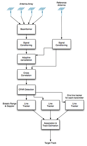

People have done passive bistatic radars capable of tracking aircraft using very low-cost RTL-SDR receivers, but these are PC-based rather than Arduino.
The general principle behind a passive bistatic radar is that an emitter of opportunity (e.g. broadcast FM or TV) is received on one channel with a directional antenna and the reflection of that signal off the target is received on a second frequency coherent receiver and directional antenna. The time and Doppler shift of the reflected signal are determined using cross correlation techniques to give the differential range and velocity of the target.
Needless to say, achieving success at this sort of thing requires a significant level of understanding radio electronics and digital signal processing.

Ok, so basically recreate this with RADAR modules instead of ultrasonic modules?
