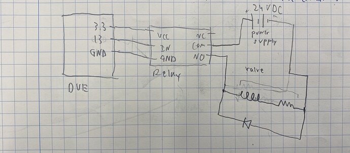

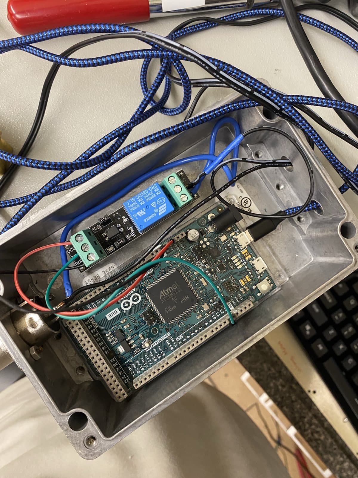

I'm using an Arduino Due to open and close a relay that toggles power to a valve. When the valve is powered, the Arduino will occasionally randomly disconnect from the computer, here is what I know
  • It only happens when the other side of the relay is powered
  • I cannot get it to happen reliably, sometimes it will work perfectly for 100 opens/closes and other times it will fail the first time I try and close the valve
  • I have swapped out the Due for another Due, and the Relay for another copy, the wires connecting the relay and the Due, the power supply, the valve, the wiring between the relay, valve, and power supply, as well as the housing, and the issue still happens
  • The relay is rated for the power being handled on the other side.
    I've included an image of the setup, the circuit diagram, and the code. Any help would be greatly appreciated as I am at a loss of what to do

Valves are usually inductive, Install a kick back, free wheel, diode across the load!

Ahh. I see a possible problem.
Your photo shows both jumpers populated. So the 3.3V line from the Due is being asked to energize the relay coil. How much current does the coil draw?

do you mean a flyback diode(thats what came up when I googled)? I'm inexperienced when it comes to circuits so I'd really appreciate if you could elaborate

I'm not quite sure this is what you're asking but: I stuck an ammeter between the 3.3V port and the VCC line, it measured 0.108A. The issue only occurs when closing the valve, which is opening the circuit, which would mean a stoppage of current no?
Already tried out of enclosure, none of these wires are AC, have tried multiple USB cables.

Think like this: Note the direction the current is flowing when the relay is active, ON. A magnetic field exist in the valve and when the relay goes OFF that energy wants to maintain the current flow. This causes sparcs in the relay, and RF type noise that tilts the controller.
Install the diode so this switch off current has a path to go!

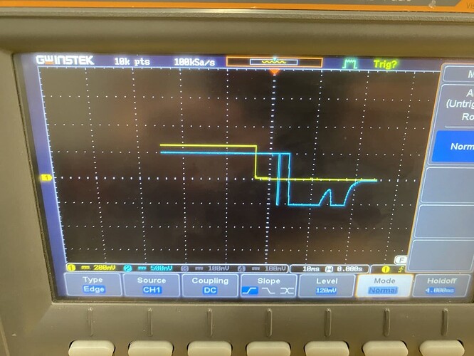

I checked with an oscilloscope, the yellow line is the voltage from pin 13 as I close the valve, the blue is the voltage across the valve(ignore the units in the bottom left, they are wrong). I think it is very clear from the messy behavior that there is backfeed from the valve. I am going to do two things, follow Railroader's advice and add a flyback diode, and look for a better relay that has one already built in, as I need to make several of these. I'll report back when this is done.
Thank you so much to everyone on the thread!

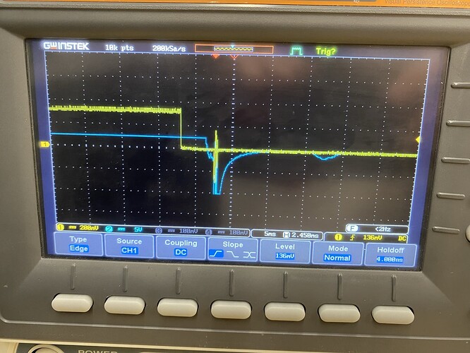

Here is a picture of the Oscilloscope when the due actually disconnected from the computer

Just to make sure I am going to do this correctly, the Diode should be connected like so?
Also, the valve uses a solenoid to open and close, in case that is relevant, and it opens when power goes to it.
Yes. That's the way to connect the diode.
Would the flyback diode need to be able to handle the full wattage(24V at 0.4A, so about 10W) that goes through the valve, or can it be smaller
It should handle that current, for a very short period, use a 1n4007 and you are ok
The diode will not see any 24 volt, only the current flow through the coil and that is for a very short time. Current x 0.7 volt x a few ms makes a very low power discipation.

Hi, @reedjc
Look at this image.
Move wire A over to be next to wire B, that is to keep the load wire AWAY from the controller.
Tidy up wires C so that they do not intermingle with the load and power wires.
I would change the layout.
Turn the relay module around and have the load and its power wires come in on the left side, so that the load current goes NOWHERE near the controller.
The signal wires to the relay module will be then at the other end, AWAY from the load wiring.
That looks like a metal case, have you got it grounded, at least to the DC supply negative?
PS. Can you see why the system resets? Load power wires with 0.4A next to control wires with approx 1/100 of the 0.4A current running through them.
