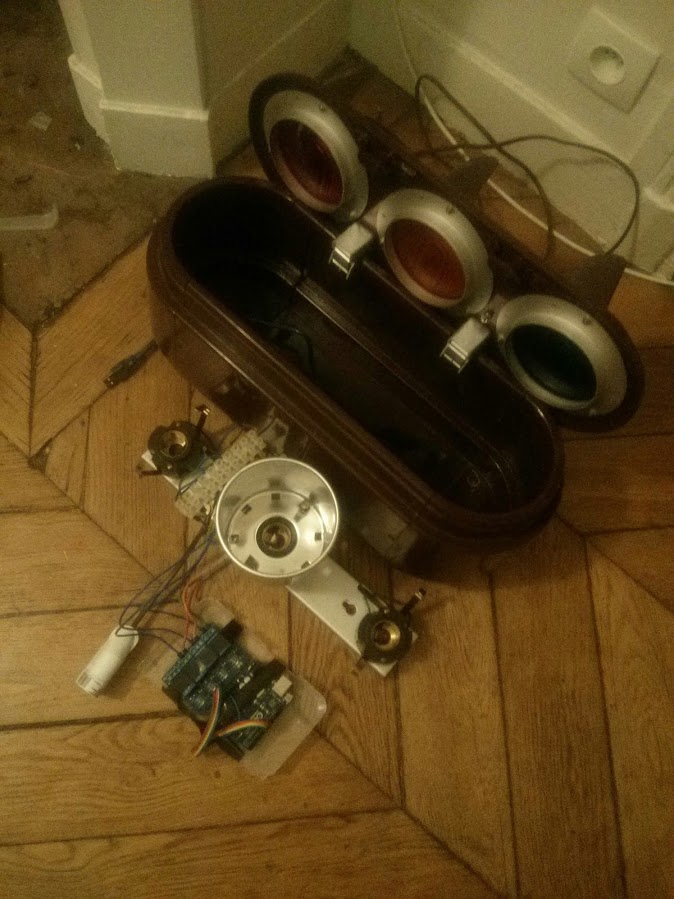

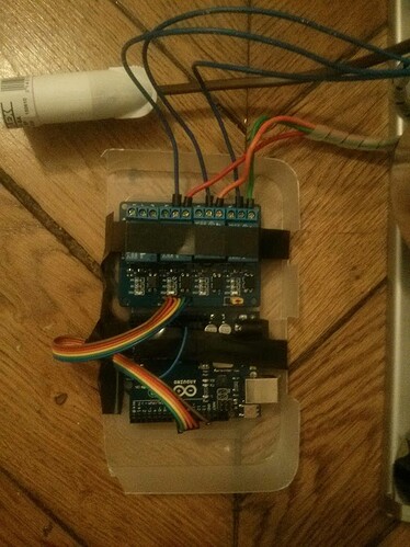

Here some pics of the project :
Try a 470uF electrolytic capacitor from 5volt relay supply to relay ground.

I tried a new scenario :
Plug only the USB for powering the Arduino
So in this situation the Arduino is powered via USB (on a laptop on battery)
The lights are powered by the wall outlet.
I added some logs, add saw that the relays don't behave randomly but the arduino reboot after 8/10seconds.
Any ideas ?
