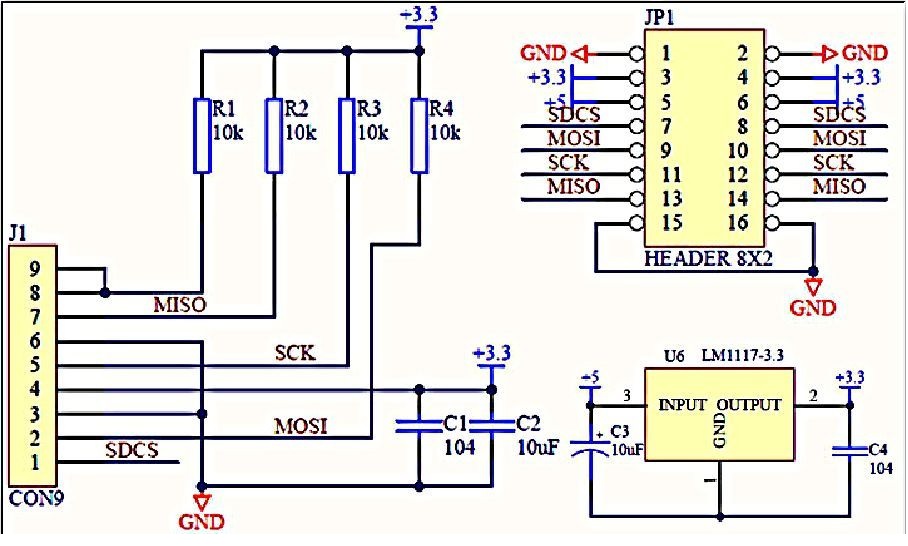

I bought one of those cheap SD card reader breakout modules on eBay and I'm not sure how to power it.
http://www.ebaypa.com/albums/20120005/sku076938-3.jpg
I read some wiring instructions and got confused by the supply voltage which should be 3.3V for the SD-card. Therefore it is necessary to use a level shifter in order to use it with a regular 5V Arduino like the Uno. Since there is a onboard voltage divider (aka the crappy low-tech level shifter) there is no need for a level shifter and you can supply it directly to 5V - as said in the item descripton "Support 5V/3.3V input". However some wiring instructions state that you have to supply both voltages 3.3V and 5V for this sd card module (according to the layout). Does anyone have such a module?
It has not arrived yet but I want to etch a pcb to easily implement it into my circuit. Therefore I need to know it beforehand :smiley: the ebay seller hasn't replied yet

I have several of those cardrs.
The design is BAD , and I have redesigned mine to look more like this:
http://www.ebay.com/itm/1pcs-SD-Card-Module-Slot-Socket-Reader-For-Arduino-ARM-MCU-NEW-/400645164814?pt=LH_DefaultDomain_0&hash=item5d48500f0e
(scroll down)
only difference is that I use 2k2 and 3k3 resistors.
after modification they are stable
Note: I mounted resistors into the card
This seems to be the the same design as mine (LC Studio stuff). What do you mean it works bad/not stable? Did you supplied it with 5V and used some resistors to get 3.3V for the sd card?
5V supply is OK. onboard regulator takes care of this.
The 3 other OUT-lines need voltage adjustment. The original solution is NOT very good.
I've experienced that board worked unstable.
The suggested fix can be done - parly using the already ombord 10k resistors
..also: be sure to make pin 10 an output
I assume this is the resistor setup of the original design: R1 = 1,8k; R2 = 1k; R3 = 1,8k; R4 = 3,3k; R5 = 2,2k; R6 = 3,3k - so what did you replaced/changed? I took this image as a reference.
And again - do I have to supply both voltages or does it work with either 3.3V or 5V? Just asking because I read instructions stating one has to supply both on that lc studio design :roll_eyes:
my card matched the design shown.
I'll make a sketch (photo) of my changes.
My original har 4x 10k resistors.
It works reliable with voltage dividers using 4.7k's
ADDITION: R2 must be removed!
thanks for images, now I know what to do :smiley: the wiring stays the same? D10 mustn't be wired but stated in the code as an output, right?
D13 = SCK
D12 = MISO
D11 = MOSI
D10 = n.c. (CS)
I guess you're right!
The rewireing now makes CLK, MO and CS feed approx 3.4V to the SC card (2/3 of 5V)
Remove R2 before makeing the bridge
