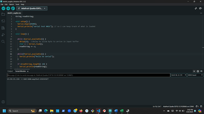

Very new to Arduino. Been coding ESP32 chips mostly with ESP-IDF. Now using Qualia-ESP23-S3 with Arduino IDE 2.3.2 on Windows 11. This board has 1 USB-C port which I use to connect to port COM3. Uploaded the following sketch to the Qualia board:

Code compiled and uploaded properly. Output window shows the following message:
Writing at 0x004354e5... (100 %)
Wrote 157728 bytes (101221 compressed) at 0x00410000 in 1.3 seconds (effective 964.9 kbit/s)...
Hash of data verified.
Leaving...
Hard resetting via RTS pin...
But Serial monitor, which connects to port COM3 (the same port my board is connected to) does nothing at all.
Serial monitor Baud rate is set to 9600.
USB CDC on Boot is also Enabled.
Even if I enter a message in the input screen, it displays nothing at all.
I'm at a loss for how to proceed. Appreciate some help.

Not sure what the purpose of the spyglass is. Pressing it simply takes the Serial Monitor away. Re-clicking it makes it reappear with the following:
15:04:15.106 -> ESP-ROM:esp32s3-20210327
Not sure what this is supposed to tell me. But when I write something in the Message area of the Serial Monitor, nothing appears as you'd expect to based on the sketch I uploaded.

THe only output in the serial monitor is
which I get when I click the Serial Monitor spy button in the top right of the IDE.
Even the following section from my sketch doesn't show anything in the Serial monitor. I'd expect the serial monitor to display "hello no serial" if the serial wasn't yet available:

@ptillisch Tried the simple code you provided. Compiled and uploaded correctly. But nothing gets printed to serial monitor. Here's a question - I've connected the Adafruit Qualia board using a USB cable to a USB port on my laptop. Is there any other connection I need to make or look out for? Is there a particular type of USB port on my laptop I need to connect the Qualia board to?
