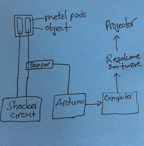

Please draw and post as jpg a diagram of how you want this project assembled.

The basic idea of the circuit is attached. Something like this would probably be easiest to make. I honestly don't want to hurt anyone, the point is to find that fine line of uncomfortable but get-overable.

O.K. so you've liberated your flash unit from the old disposable camera... Take a look at the values on the capacitor. See the working voltage? that should be your first red flag, but, let's go a step or two further...
Disconnect the flash tube's leads, connect them to (just lay them on) a piece of aluminum foil, connect the AA battery to the circuit and watch and listen to it charge. When charged. and with the flash leads touching the foil, trigger the flash circuit.
DOES THAT LOOK SAFE TO YOU?? If so, replace the foil (what is left of it) with the first two fingers of your right hand and re-execute the experiment.
then re-think your project.

I do not understand how you can charge up a 'shocker' circuit without a storage element (the capacitor).
you need a fair amount of voltage to get through the skin and not much current to burn, once you get through the outer (dermal?) layer of skin.
Most people here are very leary of potentially dangerous projects and really don't like things involving 'BURN'.
