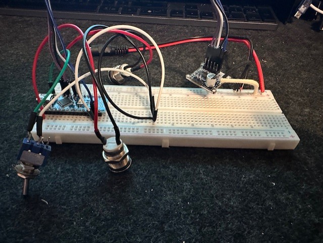

Hi all,
I previously had a post about my turntable (record player) Motor setup, with an arduino nano. I was having some issues with the motor not actually moving, and making a cogging-like sound. When I was messing with things, it would occasionally spring into life, but I had no idea why.
When I was just "trying things', I bridged pin 13 and 3v3 on the nano, and it started to work perfectly!
So, Is this a bad thing, or expected, for some reason?

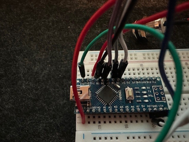

Without Pins 13 and 3v3 connected together, it just cogs (not sure if that's the right term for this particular instance - not turning, just making a noise). Is there something else I have wrong, or is this expected on a Nano?
Post #4 shows a breadboard, but it is now soldered into prototype board. Everything looks correct in terms of the soldering. I just want to try and understand why it works perfectly with those pins connected. I tired both on their own - but they work perfectly when jumped
I'm not an expert, and your breadboard photos are difficult to decipher, but to me, it looks like you have/had no button connected to Pin D13, which is where your code expects a button that will be pushed when you want to run motor.enable().
I don't know what voltage threshold must be crossed for a digital input to be considered to be LOW, but if the voltage supplied by your 3v3 pin is sufficiently low to set the pin state to LOW, then it would cause motor.enable() to be called in each loop.
Conversely, without supplying the D13 pin with a LOW voltage, there will never be a call to motor.enable().
Since pin 13 is also tied to the onboard LED and this is a clone, there may be some extra circuitry (or not) associated with that pin. I would move to a different pin.
Thank you both for your replies!
I just moved Pin 13 to pin D2, and it worked first time! Thank you!
