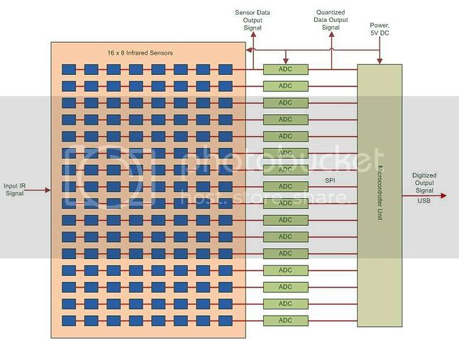

I don't know if you've seen this Multi-touch Input Sensor based of Arduino MegaMulti-touch Input Sensor based of Arduino MegaMulti-touch Input Sensor based of Arduino Mega | Arduino Blog i made this over a year ago and i plan to expand on to it now i was thinking about creating a cascading system utilizing arduinos and i'm just working out the best implementation for this expansion i had 2 ideas either to create a traditional SPI Master slave configuration where the master polls individual slaves for information and which it then processes and sends to the computer or to user a daisy chain where the data is collected from all arduinos then sent to a master controller in one swoop which is then processed and sent to the pc.

There is also this method i used this in the board to interface with multiple ADCs this allowed for polling of multiple ADCs in parallel of sorts. I wonder if this can work with Arduinos.
This is more of a variation to the traditional bus design; SCLK, MOSI and SS are all common and MISO is not.
That's exactly the method I suggested in a thread a couple of days ago. The only hassle is that you have to "reconstruct" the data because you get 8 bytes in with all the "0" bits in one byte, all the "1" bits in the next byte etc. But depending on the application that may not be an issue.

One last thing, at the moment my prototype board has the following architecture where the SPI interface between the ADC and the Arduino is Bit Bang SPI using the bus architecture model as what i have posted above.
Now what i want to do is expand on this project by having multiple modules such as this sending data to the pc for that i though i'd use another arduino (just one as a master) that acts as a data concentrator to collect all the data from multiple modules and send it to the computer. After reading what you guys said, I'm just wondering would it be possible to change the Bit Bang SPI to hardware SPI while at the same time have the master arduino acting as a data concentrator on the same bus? it would kinda be like this:

The drawing shows a parallel approach that has to use bit banging. This puts it behind the 8 ball for speed for starters, but the more inputs you have the better it gets and there will be a point at which it will be faster that daisy-chaining using the SPI hardware. What that point is I don't know.
For example if you have a Mega you could feed say 48 ADC MISO signals into the processor, The code would look something like this

The drawing shows 8 sensors going to a single ADC, are they 8-input chips? What sample rate do you need?
At 8 bits each that's 1024 bits of data, have you done the maths? At the end of the day all this data has to get to a PC and AFAIK the fastest you can do this from an Arduino is 115200bps (via USB anyway, maybe using Ethernet would be faster).
Yes, I'm using a MCP3208 its a 8 Channel, 12-bit ADC. For my final prototype i intend to use 5390 sensors; however i plan to threshold sensor values to restrict the amount of data flow; Further more i plan limit the number of inputs to 30 which equates to about 175 sensors; this should decrease the bandwidth i need even further- 1751250 (number of sensors * bits per sensor * samples per second) = 105000bps this is under the 115200bps that the Arduino can output. So theoretically it should work.

I guess you are right i've been thinking it over all day yesterday, Ethernet with a simple chat server maybe the way to go it should be much faster for communication plus it'll give me additional bandwidth just in case for future expansion. So reading over everything you guys are recommending that i keep the parallel approach for acquiring data from the sensors to the slave arduino but i should go with a traditional master->slave hardware spi configuration for data concentration on the master arduino and ouput it all via ethernet?
I think the parallel approach is good for a LOT of inputs, but as I said you'd have to do the maths to see at what point it makes sense.
OK, I just had a look at the 3208 specs, it seems that every transaction needs 3 bytes (the first one sets the channel) and there's no way around that. So all of a sudden the time for each reading is 3x what we've been talking about.
And because you can't daisy chain the ADCs you can't use SPI hardware in any mode but the normal "multiple SS" pins. So yes if you want to be able to expand the system I think you should have slave Arduinos that handle N ADCs. These slaves should probably be daisy-chained but that depends on the maximum number of slaves you think the system will go to.
The slaves handle the ADCs and reduce each sensor to an 8-bit value stored in an array. On receiving a "SPI about to start" pulse from the master they load the next value from the array into SPDR.
The master then does SPI.transfer() N times where N is the number of slaves.
Thus expansion is simply a matter of changing N, up to the point where the available bandwidth or capability of the master is exceeded.
