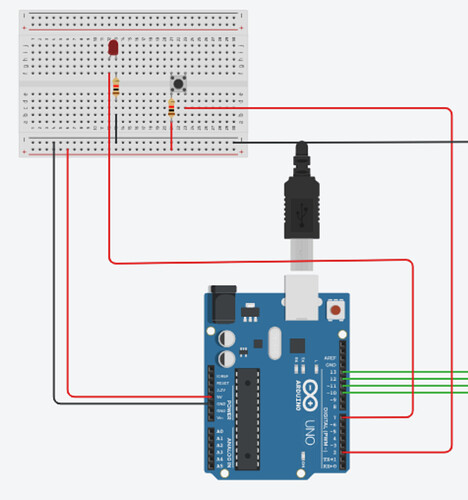

Connecting two arduino boards by SPI
master arduino code

slave arduino code

help me to identify the issues.
It doesnt show anything in serial monitor

  • Your 1k switch resistor is shorted out. :woozy_face:
  • Your switches should be wired to GND as S3 below.
    You will then need to use this in setup( ) pinMode(BUTTON, INPUT_PULLUP);
    NOTE: A closed/pushed switch will read as a LOW.
