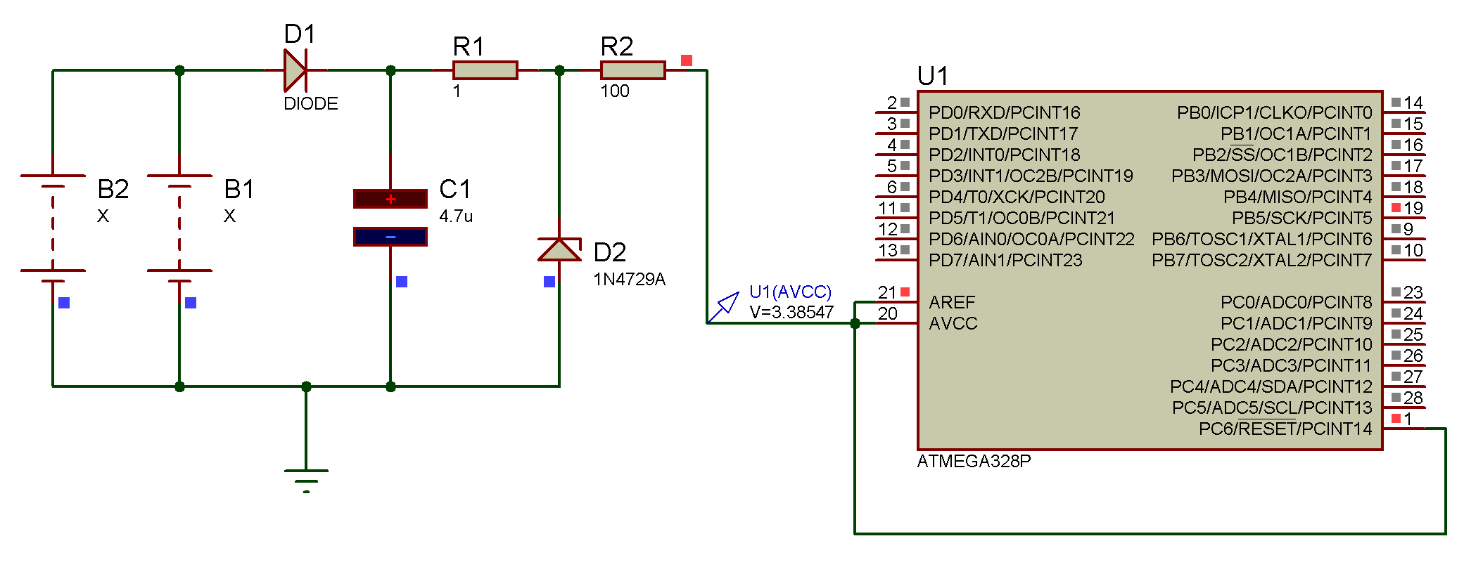

So, the main problems now are how to build the charge regulator for nicd batteries or lipo with basic components that I have access to (diodes, zener diodes, transistors, voltage regulators) and how to control the voltage to the microcontroller and the antenna with "low power consumption philosophy" (I suppose I have to avoid voltage regulators for this :cold_sweat:). I have connected a voltage meter to xively and, in a very cloudy day of winter I have reached peaks of 5 volts and I have got an average of around 4,5v (enough to kill the antenna).

I'm still working on a way to regulate power with minimum losses. I want to try an arrangement with a 470uf capacitor, a 2.7v zener diode and 2 panels rating 5.5v and 80-90mh in parallel.
Checking the maximum and minimum voltage requirements of the components I want to attach, I have a maximum voltage allowed of 3.6v (the nrf25L01 as extracted in it's datasheet) and a minimum voltage required of 3.3v (a humidity sensor).
I think that, every time the atmega wakes up it will consume about 80mh for few seconds before going to sleep again. So, the solution circuit I have think is the one that is attached. I suppose it has many mistakes but, as I said previously, I'm trying to learn.
