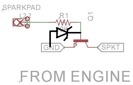

Exactly how have you got the wire to the base resistor connected to the spark plug?
The voltage off the spark plug will not be a pulse, but a firing spike followed by a couple of smaller but in the case of the arduino significant oscillations.
The 4.7V zener will not protect the transistor or the arduino as only more than 0.7V is required to damage the B-E junction.
Tom... :slight_smile:

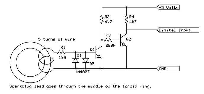

Hi, again.
Try this circuit to get your spark signal.
It uses a toroidal ring, any type will do as long as you can feed the sparkplug lead through it and wind 5 or more turns of insulated wire on it.
The number of turns may have to be adjusted for your application.
Using a ring provides isolation between the HI VOLTAGE spark circuit and the LOW VOLTAGE arduino circuit.
It also works by responding to current in the lead, which only flows when the spark plug fires.
If the pair of wires from the ring to the circuit are long, ie > 20cm, then twist them together to counteract any other noise.
Tom.... :slight_smile:
-See attachment. Sparkpad is a wire with a clamp that clamps onto the spark plug wire. It used to be wrapped but using a clamp provided more consistent results from different engines. SPKT is input to arduino.

Try the circuit in post #45.
It responds to spark current, not voltage that the capacitive pickup that you have will be doing.
