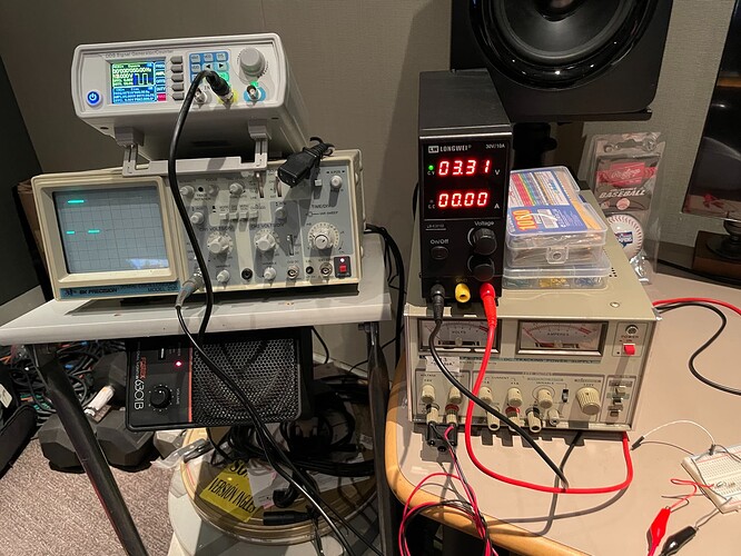

I am using an MKR WiFi1010 and have tested my circuit on the bench even going as far as buying the same signal generator and all works as it should, including having a perfect square wave at 3.3V output of the isolator circuit with a 12V input.

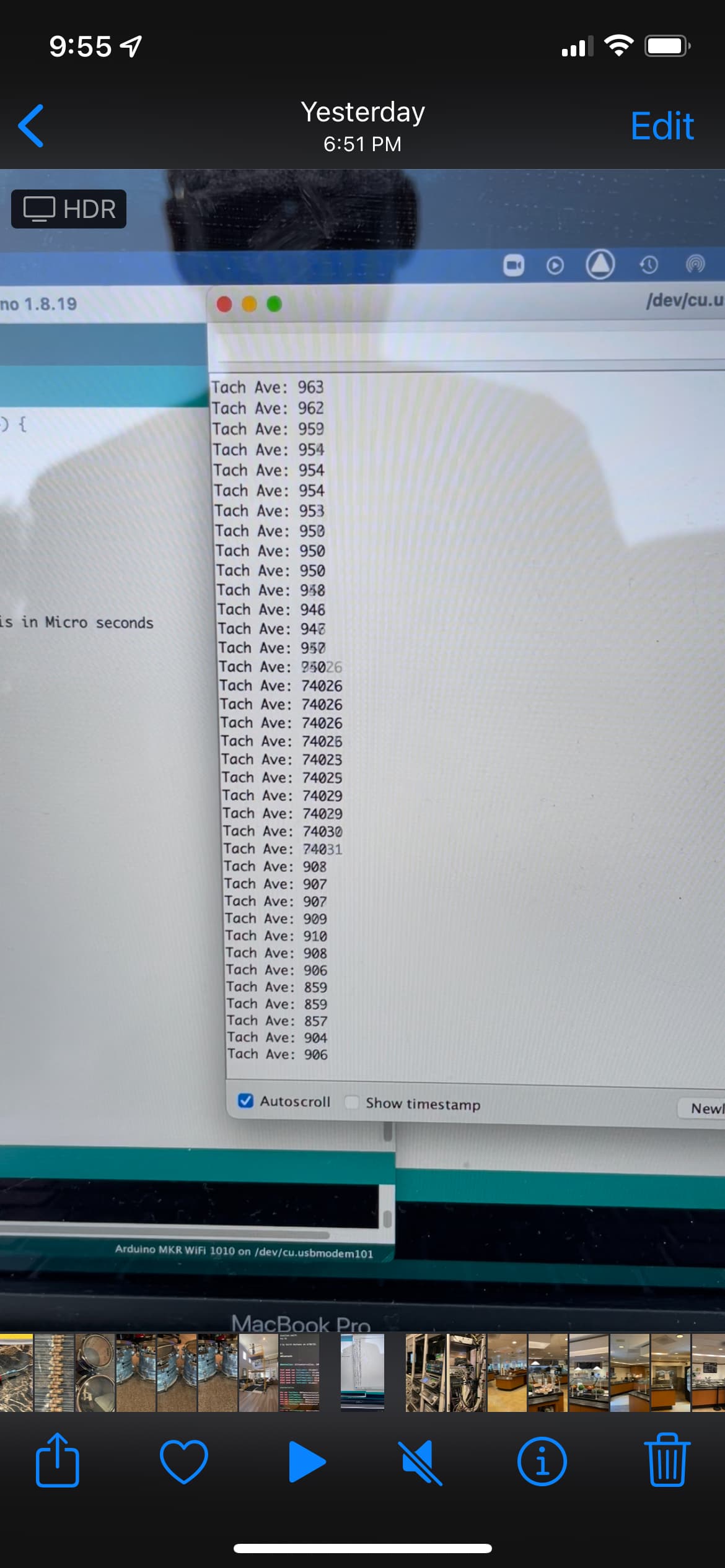

The issue I have though is that when wired to the car which is a VW bug with a stock 1600 DP engine with a Bosch Blue coil and a 009 distributer, I get good readings and a lot of off the charts readings. Doesn't matter what RPM I'm at and I have tried different grounding schemes but nothing seems to make it solid. I have also measured the voltage and frequencies coming off the NEG side of the coil and while they both do slew around a bit it certainly isn't anything that result in those number readings that are off the chart.
So I'm wondering if this has something to do with my circuit, code or installation or is it actually the car itself. Could the problem be that the output of the coil is averaging at around 8-10 Volts instead of 12V so the really high numbers are actually missed triggers? Bad grounding? I'm out of ideas.

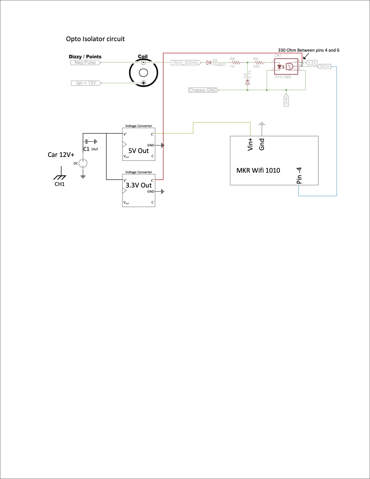

Okay well that reminds me that I don't have a single complete drawing so please standby while I draw one up real quick. Thanks!
No problem. Make the drawing. Your post is quite general and not specific enough to pin point the issue.
Add code to print out hightime and lowtime, pulseIn returns an unsigned long and you may be overflowing the int variables

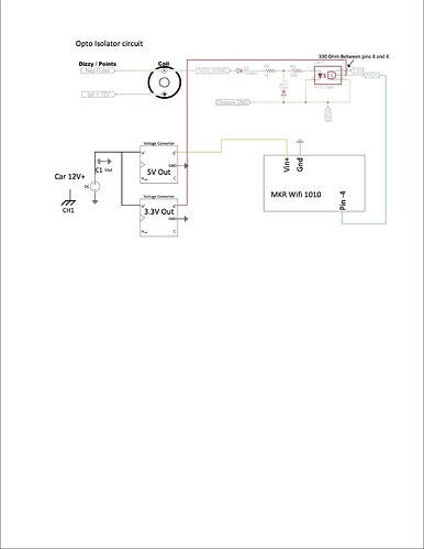

Here's my schematic..
iGaugePro Schematic.pdf (94.4 KB)
Okay, I'll give that a try.
Please post as an inline image. Some people can not download and view PDF files here.
You have a scope. Have you scoped it?
No actually.. just used the meter to check voltage and frequency. Never done that with an O scope. Just literally go to chassis ground and coil Neg terminal?
You have almost world class equipment (although somewhat old). It does baffle me why you wouldn't use it to answer the specific questions you have. Go wherever you want to go to get a useful reading - so long as the voltage is not too high.

pulseIn returns an unsigned long. Anyways, unsigned long should be used for timing variables.
Maybe try this ...
unsigned long highTime;    //unsigned long for storing high time
unsigned long lowTime;     //unsigned long for storing low time
float period, lastPeriod;  //float for storing period and last period
float freq;                //float for storing frequency
float RPM;                 //float for storing RPM
  pinMode(4, INPUT); //Setting pin as input
  highTime = pulseIn(4, HIGH);            //read high time
  lowTime = pulseIn(4, LOW);              //read low time
  period = highTime + lowTime;            //Period = Ton + Toff
  if (period < 1000) period = lastPeriod; //error: freq > 1000, RPM > 30,000, therefore use last period
  else lastPeriod = period;
  freq = 1000000.0 / period;              //getting frequency with totalTime is in Micro seconds
  RPM = (freq / 2.0) * 60.0;
  Serial.print(  "RPM:  ");
  Serial.println(RPM);
  delay(100);
